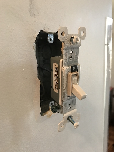

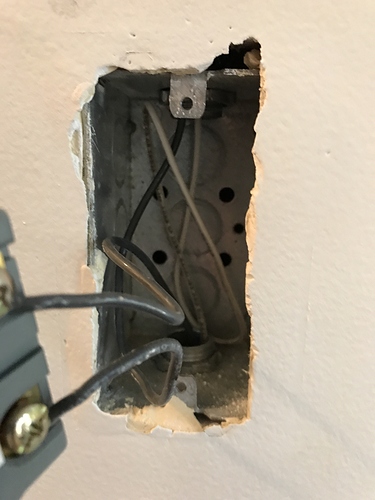

I finally found time to look at my switch box, this is just one, it’s actually for my dining room. I’m not encouraged by what I see, but I’d be interested in other opinions. Specifically, I noted that there is indeed no ground wire and only 2 wires to the switch. Last there seems to be a white wire in the box, but it is just going through doesn’t connect to anything. Thoughts?

The fact that there’s a white wire there does not mean it’s a neutral, unfortunately.
I had that exact thought. I’ll have to get out the multimeter and check
