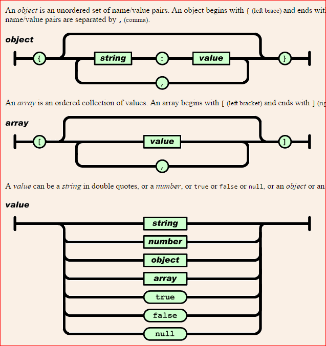

Hmmm⌠Perhaps JSON lint accepts partial objects? It does seem that the âentireâ object should be surrounded by {}, and only array / maps are [].
There must be a detailed JSON syntax spec, of course, but found this:
Letâs have a quick look on JSON basic syntax. JSON syntax is basically considered as subset of JavaScript syntax, it includes the following:
Data is represented in name/value pairs
Curly braces hold objects and each name is followed by â:â(colon), the name/value pairs are separated by , (comma).
Square brackets hold arrays and values are separated by ,(comma).
Hereâs the syntax diagrams: http://json.org/
Ron
(Ron)
May 19, 2015, 3:54am
9
Figured it out. For this json I need to create a JSONArray not a JSONObject.
