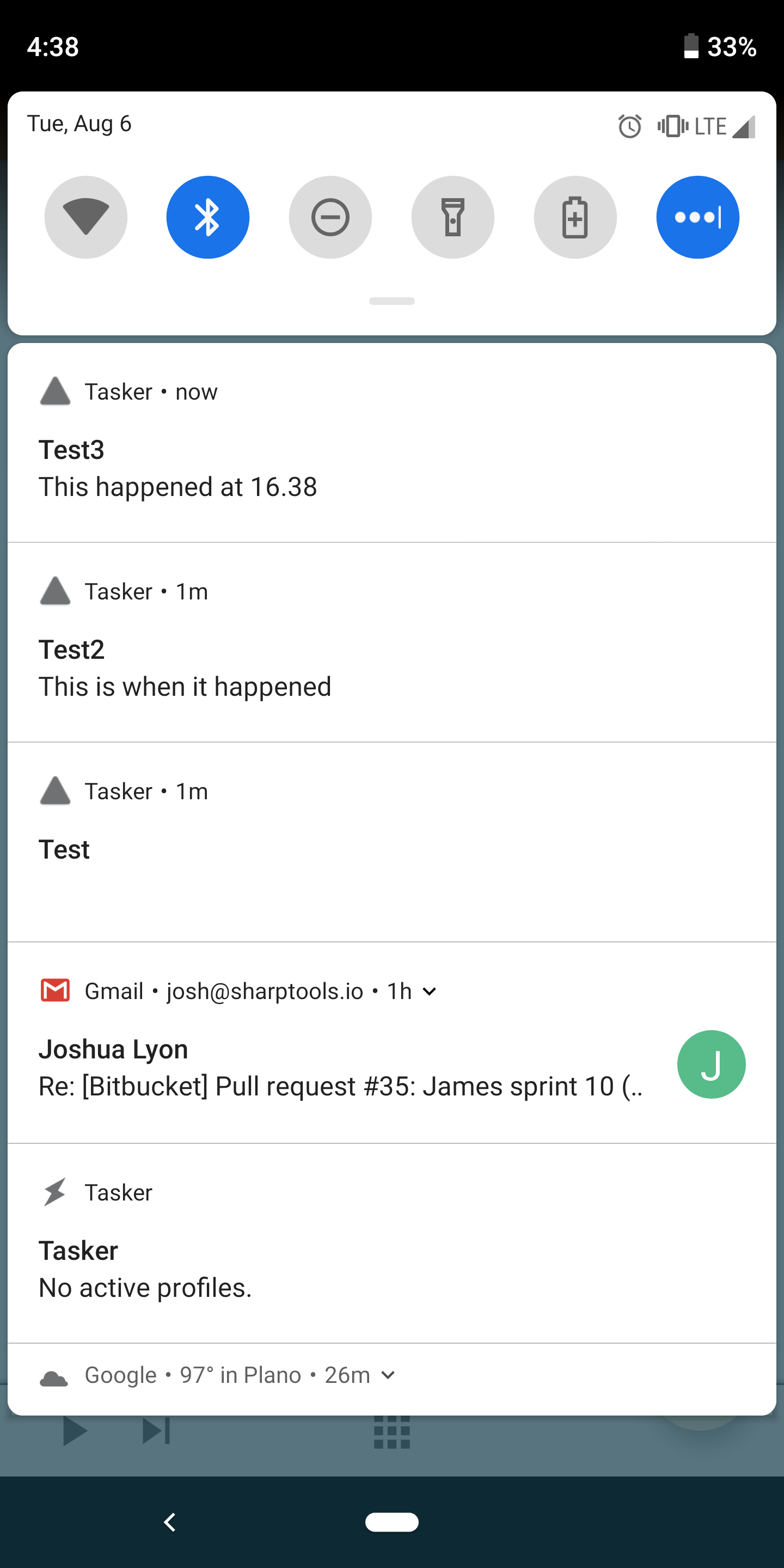

For knowing the exact time that things happen, using similar logic as above you could set Tasker variables with the %TIMES
value as discussed in a previous PM chain:

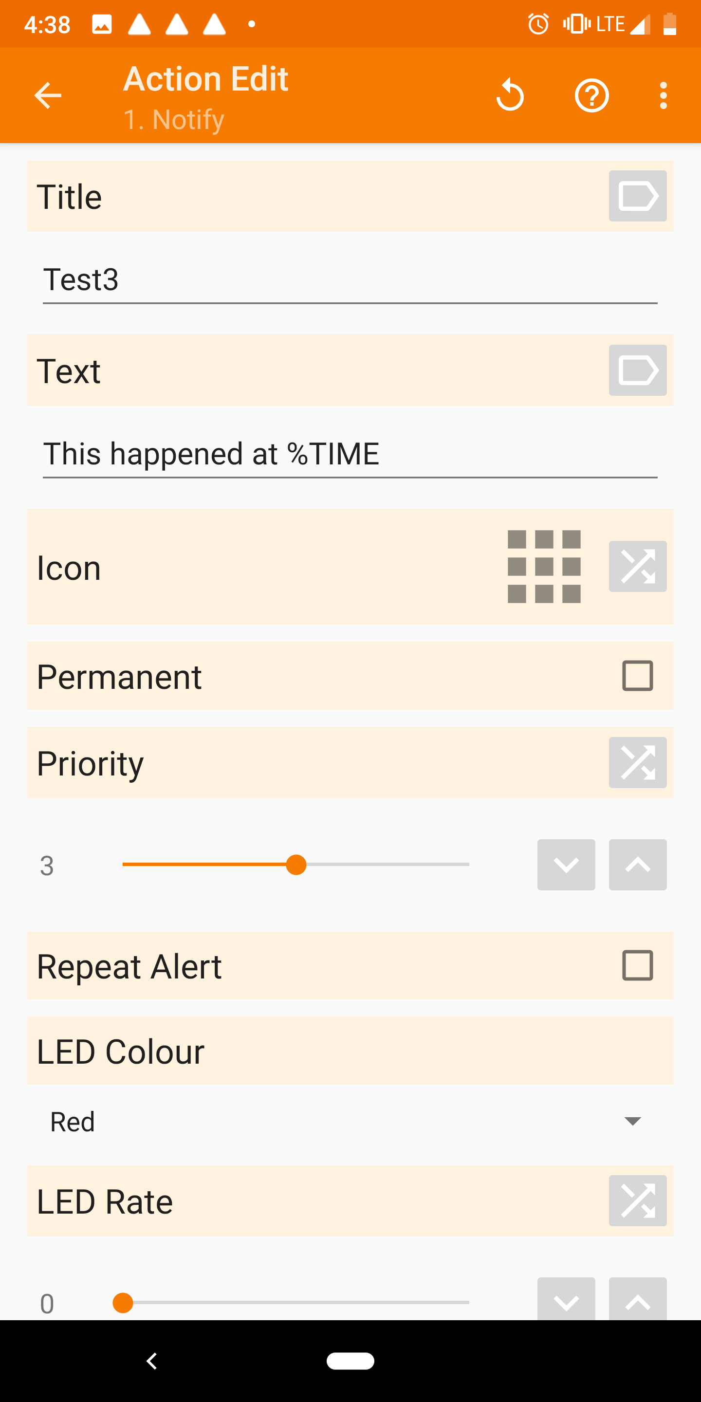

Here’s an example with the %TIME
variable being used in the content of a notification directly making it easy to see the time it occured.

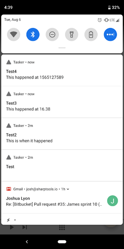

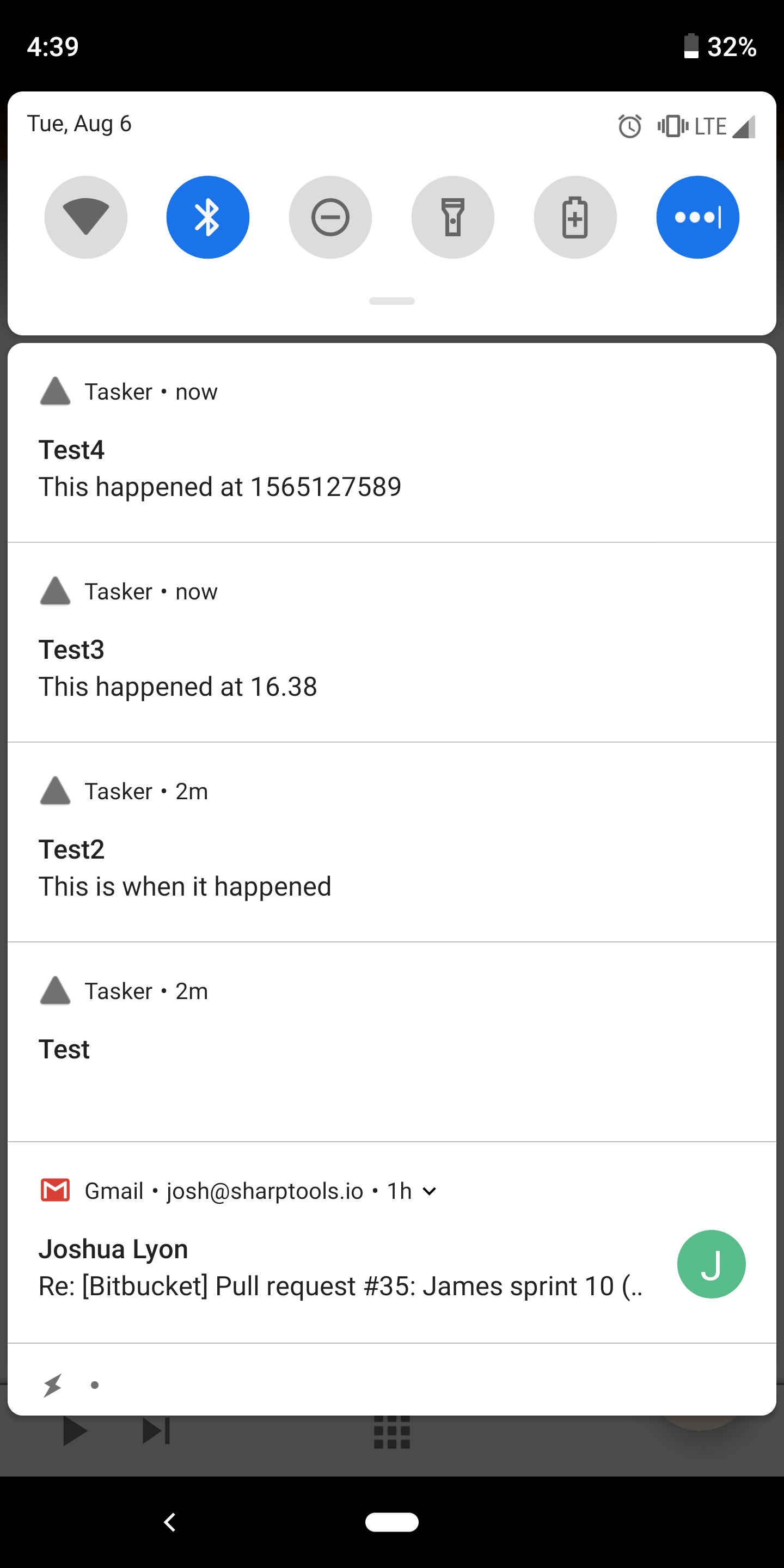

If you need even more precision you can use %TIMES
which is the time in seconds (Test4 notification):
