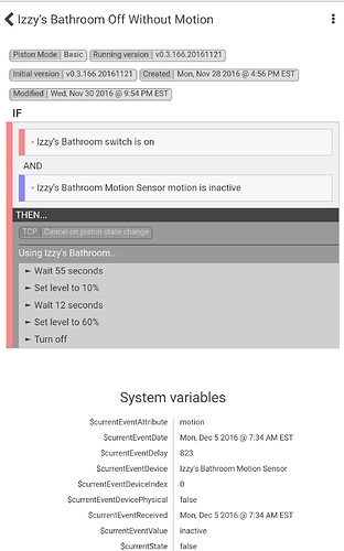

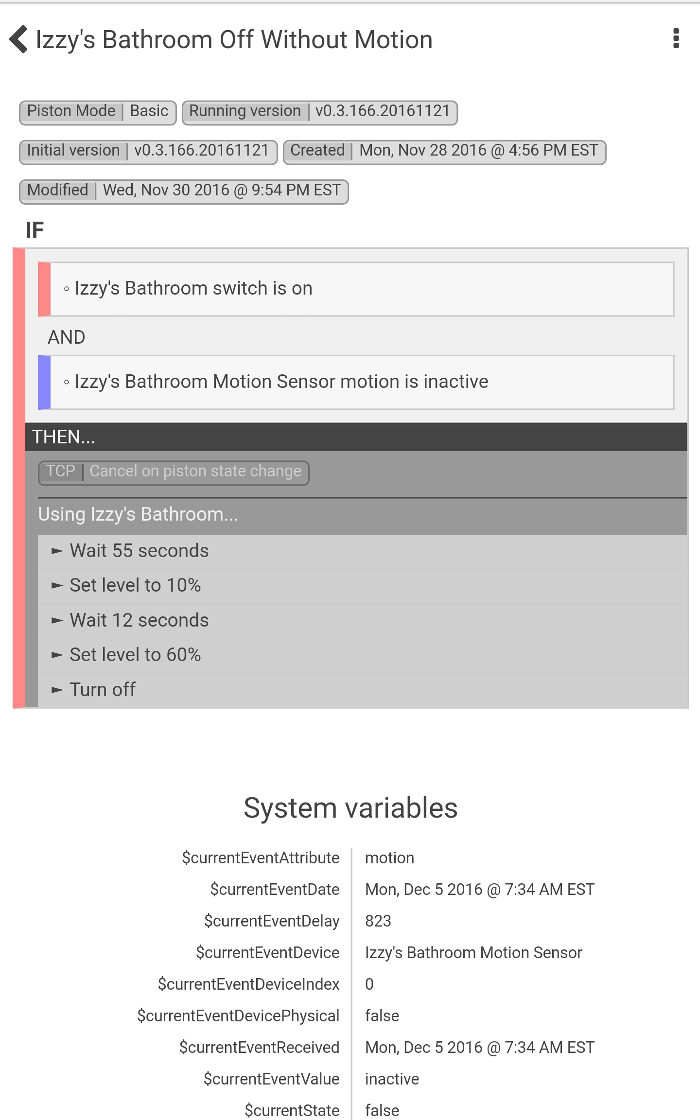

I have been using this CoRE piston for a couple days now as our bathroom night light controller. Appears to work for controlling the light and keeping it on better than smart lighting did.
Just to add to this thread. What I do as well in my daughter’s bathroom is use CoRE to dim the lights to 10% for 12 seconds before shutting off, which lets anyone in the bathroom know that in 12 seconds the lights will shut off unless you trigger the motion sensor again! This works wonders when on the toilet as someone mentioned.
If no motion then it sets the lights back to 60% and shuts off. That part happens pretty quickly and is done because if the lights turn off at 10% alexa for example uses whatever level it was last at.
