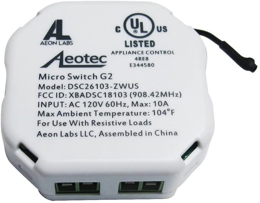

Another option is installing an in-wall (or in-ceiling) z-wave relay or dimmer like the ones made by aeotec (or a few other brands). If you installed smart switches, it’s not all that different. Though it can be a hassle to install at the fixture in the ceiling, compared to the wall at the switch I mean.

Thanks, guys. I went with smart bulbs because the boxes are too small for z-wave switches. I did use a micro controller in one light where the neutral was in the ceiling instead of the switch, and it’s been rock solid. Based on the info @JDRoberts provided about bulbs being indifferent to the existence of a neutral, I’m going to get some repeaters and see what happens. These bulbs are all outside a brick home so that’s likely a big part of the problem.
