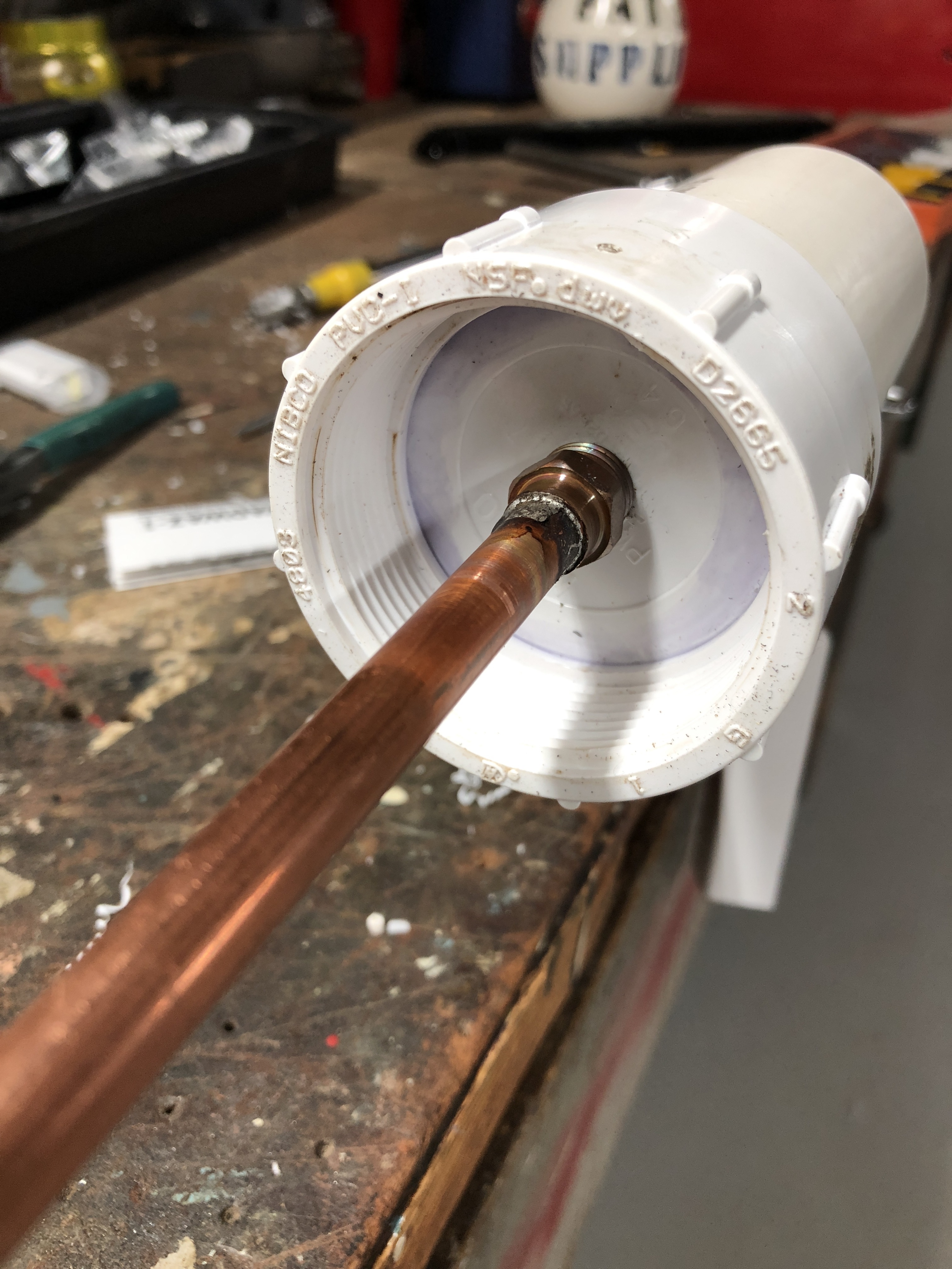

-Oil compatible float switch with 1/4" male NPT threads
-1/4" female NPT to 1/4" copper slip adapter
-1/4" male NPT to 1/4" copper slip adapter
-10’ section of 1/4" hard copper pipe

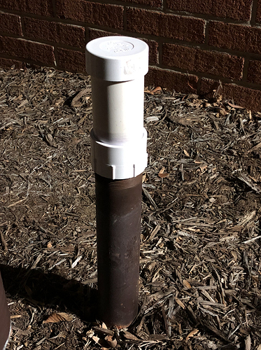

-2" female NPT to slip PVC adapter (mates with oil tank fill pipe)
-1.5" PVC cap (cut to make flange)
-2" PVC pipe, 8" long
-2" PVC cap

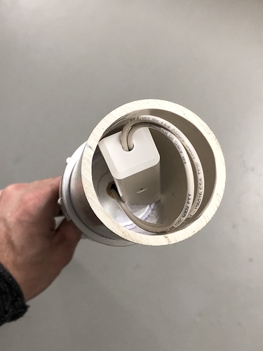

-Z-wave contact sensor with dry contact input terminals
-Some 18 AWG wire to extend the float switch leads
I assembled the above to create an assembly that screws on to the oil fill pipe and suspends a float switch in the tank so that it changes state when the tank level is at 1/4. To fill the tank, just unscrew the assembly and lift it out of the way. I configured a “notify me when” app to send me a SMS when the tank reaches 1/4 and it’s time to order more oil. Easy peasy!
