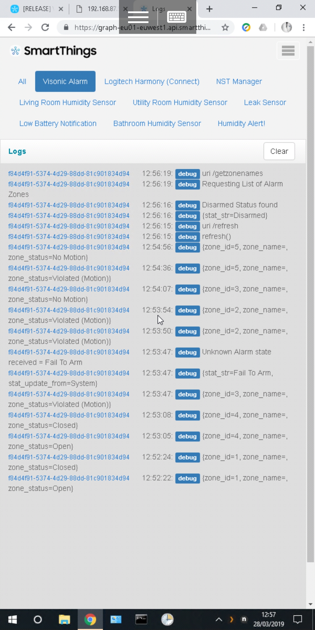

Hey, so I managed to upload the new firmware, opened the ide live logging and opened / closed doors etc, the sensors on the powermaster 30 only detect motion when the alarm is set / shortly after… I guess to save battery, looking at the logs I was walking past the sensors but nothing, so forced the alarm to arm and then walked around (neighbors will love me) it caused the alarm to go off but you can see the other sensors, so I have 2 contact and 4 PIR type.
When I then did the get zone names it crashed the wemo again (uptime reset and did nothing).
Image of log attached as was through a virtual desktop to keep it open Screenshot_20190328-125705
Let me know if you think I need to test something else?

I can tweak the code to fix the crash as I think I can see why that happens now.
