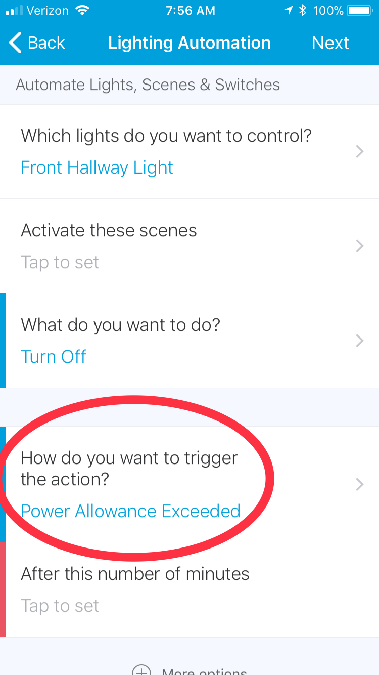

Power allowance was not removed from smart lighting. When you create the automation and set it to turn a switch off, power allowance is one of the options for triggering the switch to turn off.
I took this screenshot just now.
