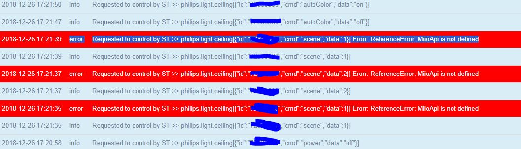

Hi , thank you for your work !!! I have a small problem with Xiaomi Philips Ceiling light , then I’m trying to turn it on/off it does not work , but I can change scene from the app . Please can you help with that .
Thank you so much .
I need a detailed info.
What device? raspberry or synology?
Mi connector version.
If you did install a latest version, use a fison67/mi-connector:test (synology) or fison67/mi-connector-arm:test (raspberry) version.
And it’s looks like a weird. After restart a docker container, one more check plz.
I don’t know what you’re saying exactly.
My english skill is not good.
Mi connector has not connection with Home Assistant…
I don’t have a Tuya? product.
Do you know what can i do to fix Philips ceiling light ? Thanks

Hi , sorry for delay . I have Pi 3b+ , running docker 18.09.0 , I have installed all of your devices , i have all most everything from your list . Mi-connector version 0.0.3 (latest). This is the log
2018-12-29 06:33:22 [info]: Requested to control by ST >> [philips.light.ceiling] >> {“id”:“728******”,“cmd”:“power”,“data”:“off”}
(node:31) UnhandledPromiseRejectionWarning: Error: changePower has not been implemented
at module.exports.changePower (/usr/src/app/node_modules/abstract-things/common/switchable-power.js:110:9)
at module.exports.setPower (/usr/src/app/node_modules/abstract-things/common/switchable-power.js:83:32)
at module.exports.power (/usr/src/app/node_modules/abstract-things/common/switchable-power.js:68:16)
at Object.module.exports.controlDevice (/usr/src/app/miio/miio.js:948:11)
at /usr/src/app/routes/control.js:10:12
at Layer.handle [as handle_request] (/usr/src/app/node_modules/express/lib/router/layer.js:95:5)
at next (/usr/src/app/node_modules/express/lib/router/route.js:137:13)
at Route.dispatch (/usr/src/app/node_modules/express/lib/router/route.js:112:3)
at /usr/src/app/node_modules/express/lib/router/index.js:281:22
at Function.process_params (/usr/src/app/node_modules/express/lib/router/index.js:335:12)
at next (/usr/src/app/node_modules/express/lib/router/index.js:275:10)
at Function.handle (/usr/src/app/node_modules/express/lib/router/index.js:174:3)
at router (/usr/src/app/node_modules/express/lib/router/index.js:47:12)
at trim_prefix (/usr/src/app/node_modules/express/lib/router/index.js:317:13)
(node:31) UnhandledPromiseRejectionWarning: Unhandled promise rejection. This error originated either by throwing inside of an async function without a catch block, or by rejecting a promise which was not handled with .catch(). (rejection id: 1)
(node:31) [DEP0018] DeprecationWarning: Unhandled promise rejections are deprecated. In the future, promise rejections that are not handled will terminate the Node.js process with a non-zero exit code.
