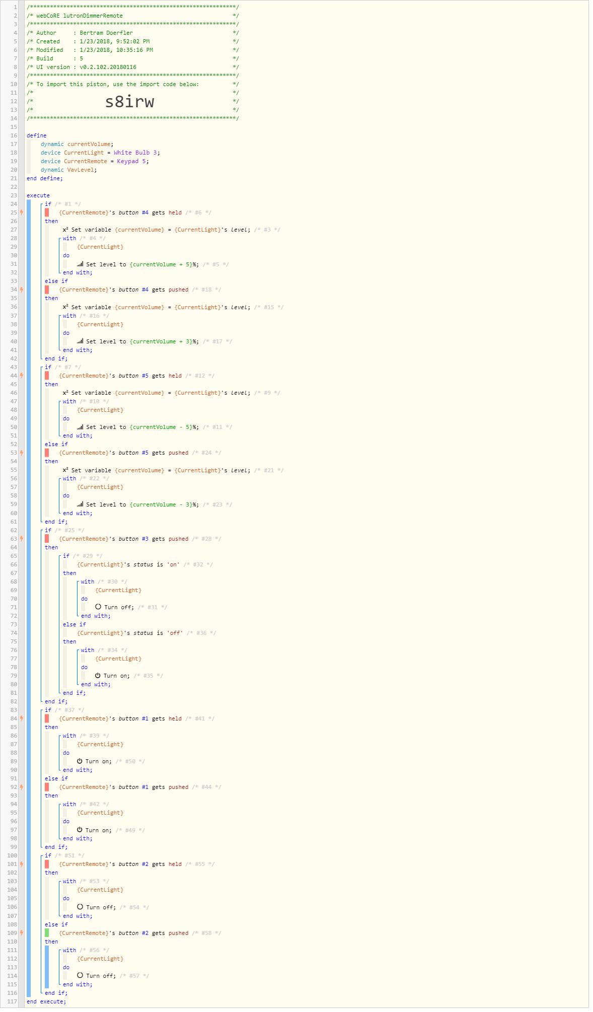

Does anyone here have a working piston for the Pico Remote? I am trying to get it to work with a non Lutron dimmer but when I add the 4:true, 5:true in the runNodeServer.js I get weird things happening; the lights go on and off , dim then go on again.
When I don’t have buttons 4 and 5 dimming buttons they work as expected.
Did anyone manage to ramp the dimming of lights while pressing the buttons on the pico and not after releasing them?
