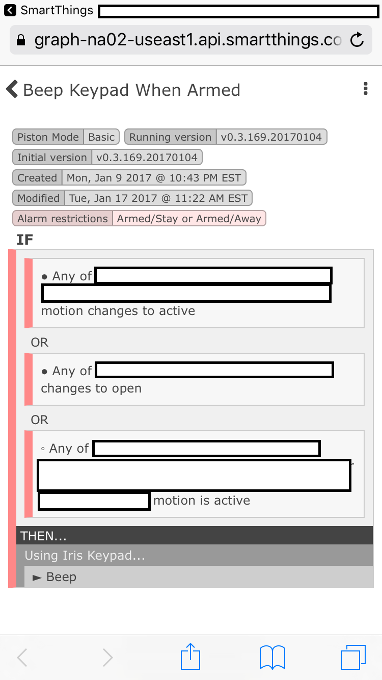

It is possible to create a workaround to create entry delays using SHM.
I did this by first creating a simulated Contact Sensor and creating a Simulated Motion Sensor using the IDE.
Then I used a CoRE piston to change the state of the simulated sensors to active/open after waiting for a set amount of time.
Here is the contact delayed open piston:
Here is the Do piston that is called to open the door:
This only activates these virtual sensors when the SHM is in an armed state.
In the SHM setup then only have the two simulated sensors.
I also setup a separate piston to make the keypad beep when motion is detected or doors are opened while the SHM is in an armed state so that I would get an audible indication when entering the house when the SHM is active.
I have a similar piston to reset the sensors after motion has stopped (or doors are closed) or when the SHM state is disarmed.
