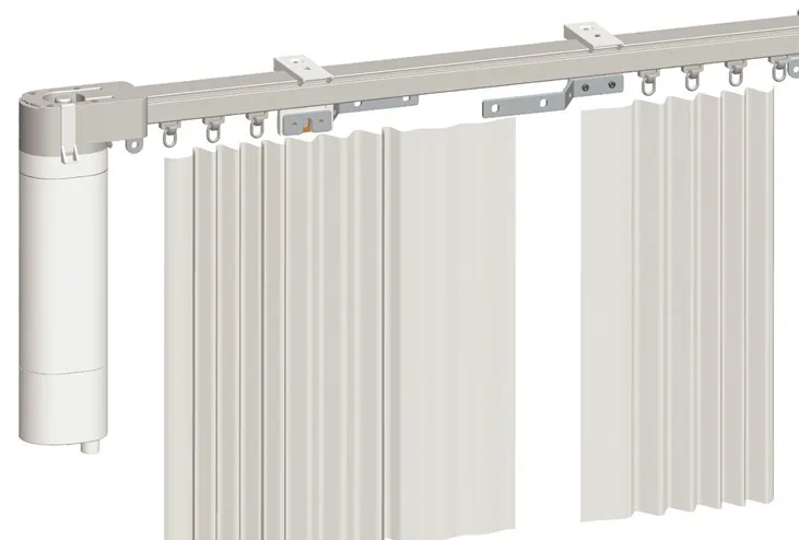

Hi Alwas … could i ask what curtain motor you are using please? want to try something similar
Many thanks!
Sure, I know buying from Aliexpress can be quite bewildering with the choice they have, specifically I got this model…
It comes with either wall or ceiling mounts, I wrote to them to ask for both which they included. It doesn’t come with a physical switch, that I sourced locally to match what I had already. One neat feature is the motor can be mounted either on the left or right of the track, as required. I chose this regular 4 wire model instead of a fancy Aqara Zigbee model because I was sure I could get it to work with the Fibaro Roller Shutter. And strangely it only took 6 days to arrive, I must of pressed the wrong button at checkout.
