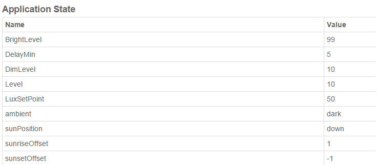

EDIT: 2/13: I know there is a lot here to digest and maybe no one cares at this point, but, here is the crux of this, I think: The only place in the code where state.sunPosition is set to ‘down’ is in sunsetHandler(). According to the platform, the last run of sunsetHandler() was before the last run of sunriseHandler() where state.sunPosition would have been set to ‘up’. So, it doesn’t seem possible that the code in sunriseHandler() executed and it does not seem possible that state.sunPosition was set to ‘dark’ after the last (reported) running of sunriseHandler().

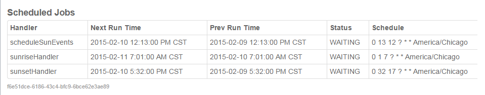

Well, ST Aaron (not to be confused with me) in support asked me to take this back to the community and recommended some tags: @April, @matthewnohr, @mager . Here’s what I presented to ST Support (with some edits for clarification since a few days have now passed):
According to status page of the SmartApp (a few hours after the lights should have turned off) . . .
. . . . my sunriseHandler() ran at 7:01 AM. This handler looks like this. . . .
Notice line 182 sets state.sunPosition to ‘up’, yet, according to the SmartApp status page (below), it is ‘down’ . . .
. . . also, there is no light meter selected in the SmartApp instance running at my house so the sunriseHandler should have also called gotLight() which should have changed the state variable ambient to ‘light’ which didn’t happen.
The reason why I took this to ST support is because it seems like the platform is reporting that sunriseHander() ran, yet, it seems pretty clear that it did not according to what the platform is reporting in terms of status of the state variable. I don’t understand how this can be a code issue.
Can anyone offer some insight? The entire code for the SmartApp is still available behind the GitHub link in my OP, in the state is was installed at my house.
