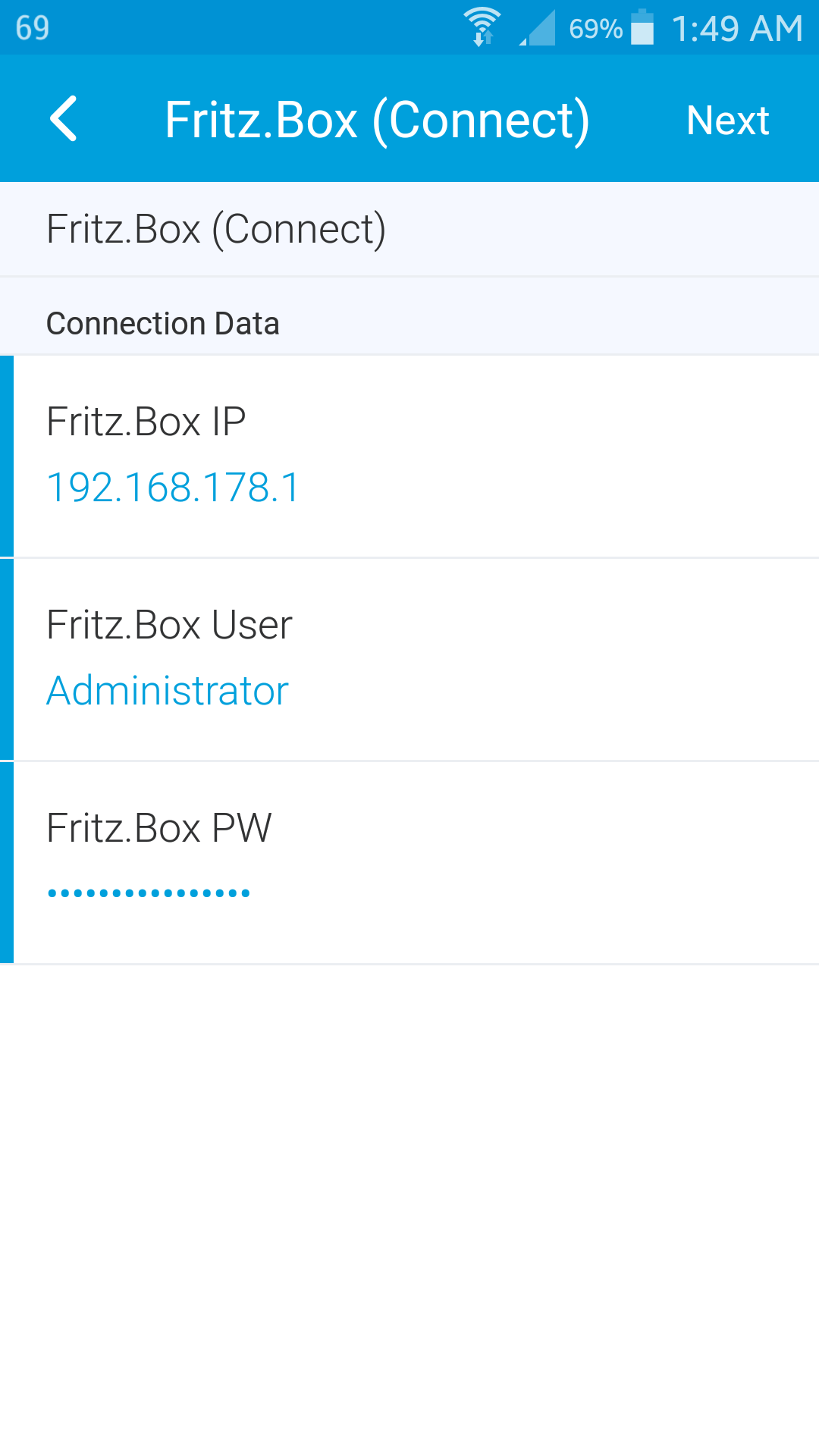

  4. Start the Fritz Connect App
  5. Enter your credentials (to access the Fritz.Box)
  6. All available outlets should be listed
  7. By selecting the outlets and clicking ok they should be added to your device list
How it looks
SmartApp
DeviceHandler
