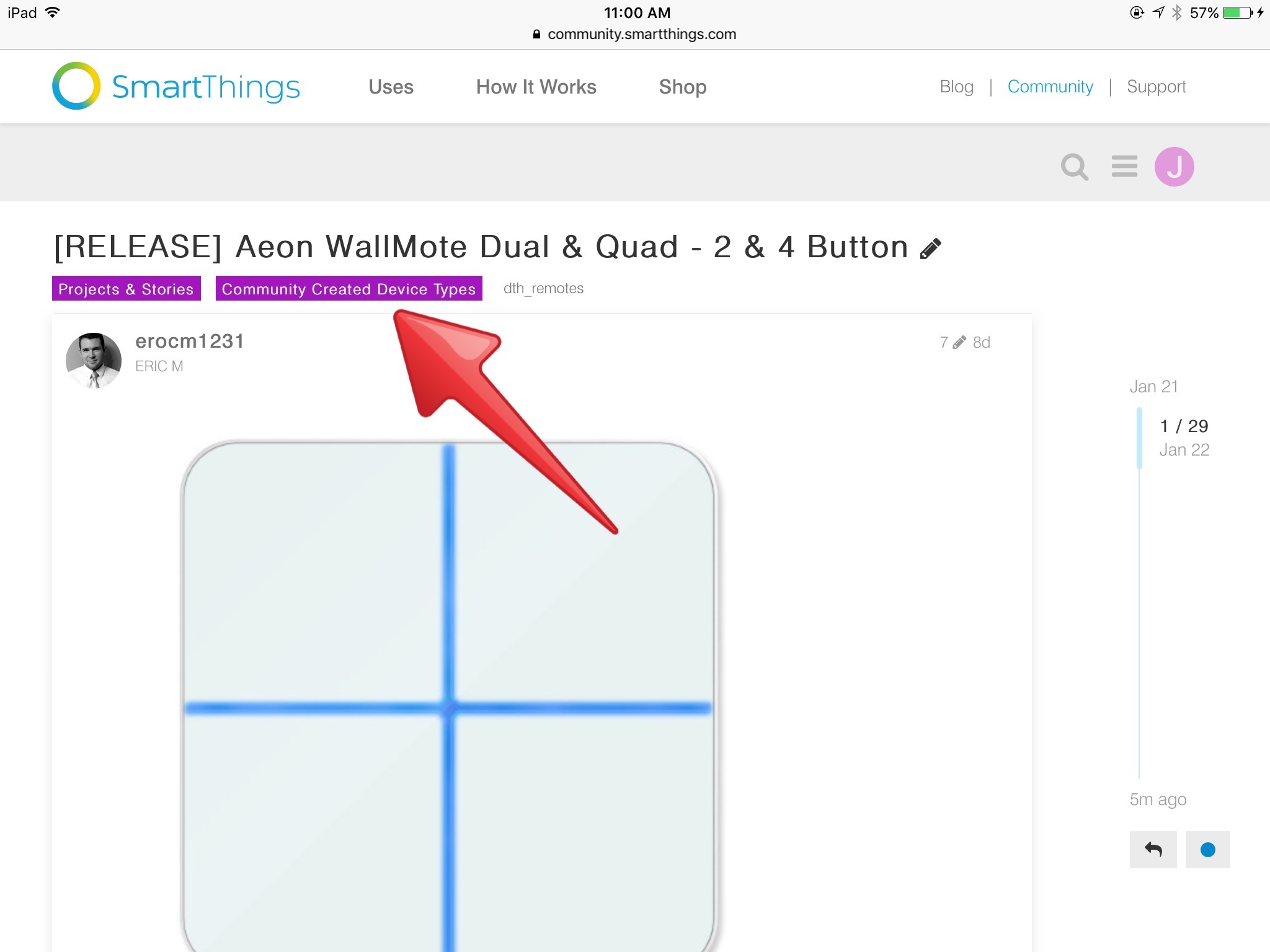

Edit the device by logging into the IDE → Click My Devices → Click the Wallmote device → Scroll down and click Edit → Set the ‘type’ to Aeon Wallmote. Then refresh in the app.
just to make sure Im doing this correctly, I should only copy the code from line 19?
Screen Shot 2017-01-29 at 1.10.33 PM
Ok. I got the code uploaded and device associated…
Eric and Jeremy thank you SO much !! I got it working…!! its so nice. I have configured two button and like you said ST allows you to control all devices…
