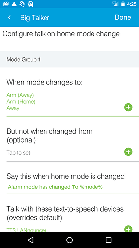

@rayzurbock
I cannot get Big Talker to speak when the mode changes - Mode, Change (Home, Away, etc) Everything else seems to work (speak) except mode changes
I have it setup as:
I believe there is a bug in the BigTalker 1.1.3 version which has been fixed in the beta 1.1.4 version. See here:
They announced on a developer call that it’s fixed now.
