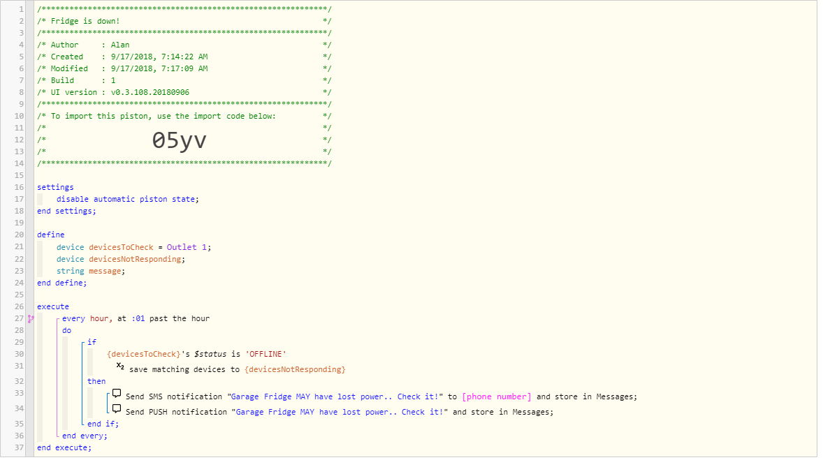

I have a smartoutlet plugged in to the other half of my GFI. I created a piston to notify me if that smartplug goes offline.
I am just getting started with SmartThings after loosing the contents of our freezer while out of town. I have ordered a hub and a smartoutlet. Where can I find out how to import your work.
