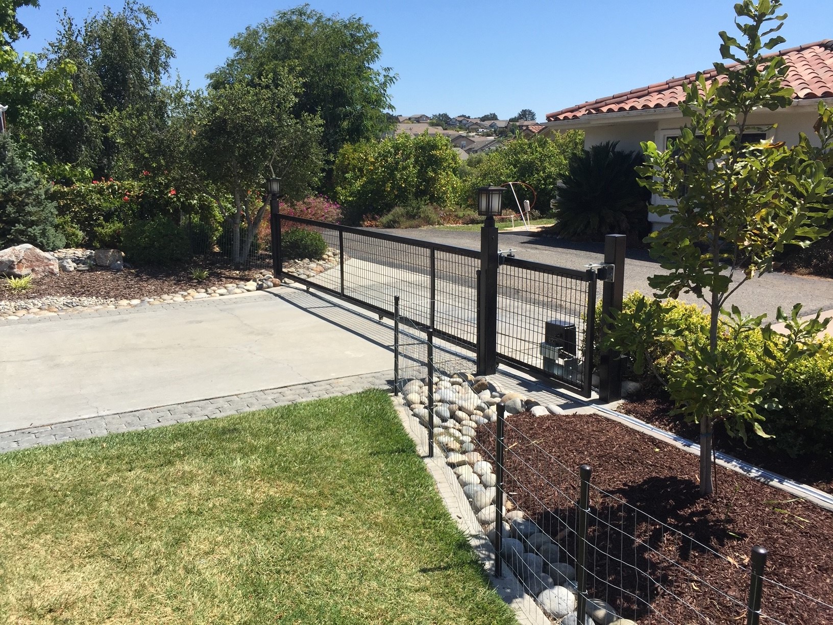

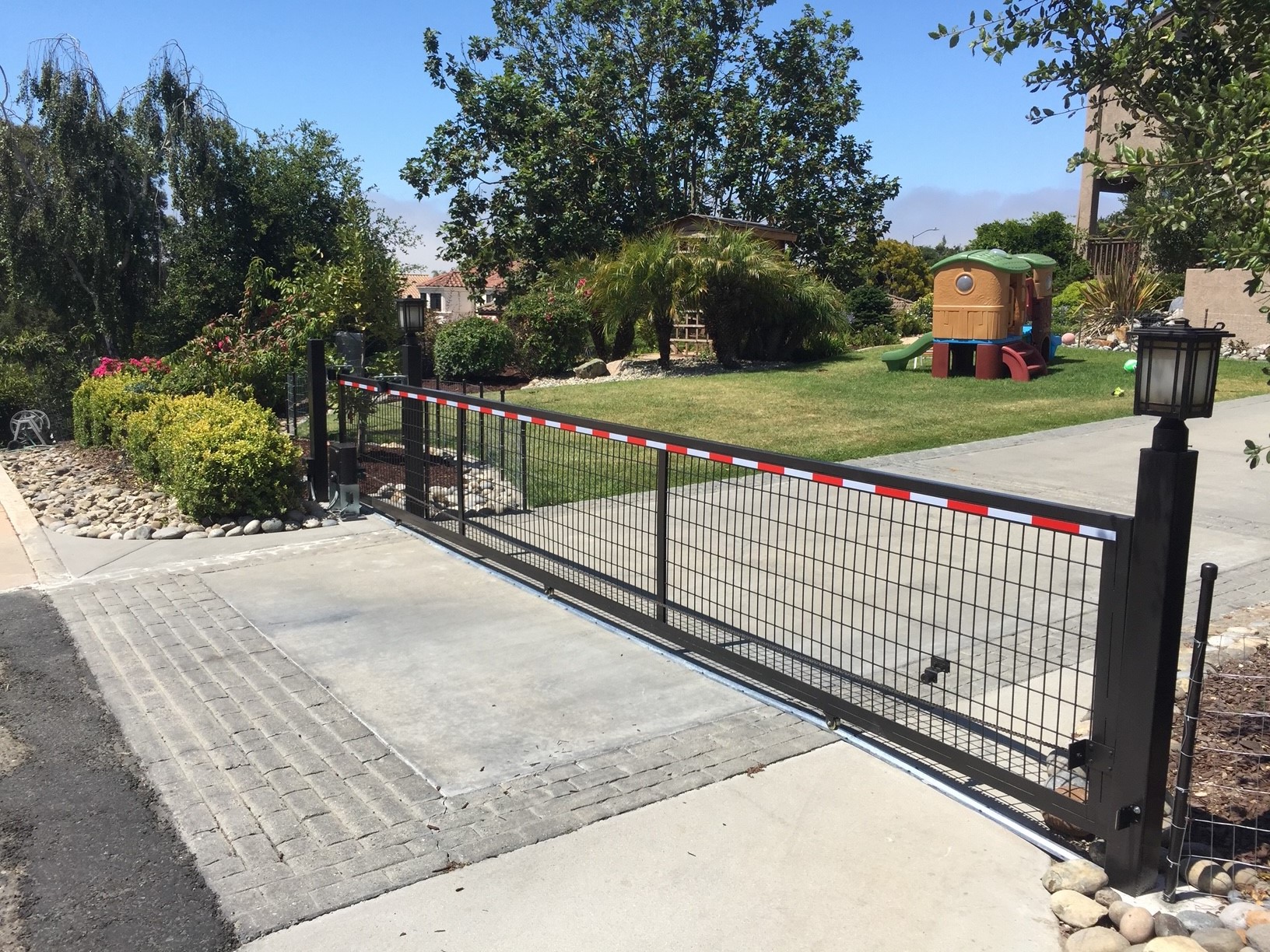

BTW this is the gate you automated below. It is strictly to keep my 2 year old boy in the front yard so my wife and I don’t have to chase him around the neighborhood.
