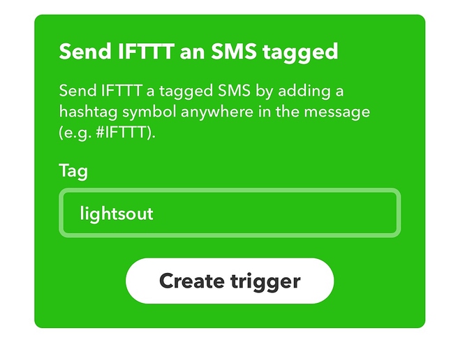

Although I was able to get this working with a “#lightsoff” text from my google voice number to my IFTTT number, the applet will not trigger with a “#lightsoff” text from any other phone number to my IFTTT number. Here’s how I’m setting up the applet:
  1. In IFTTT, create new applet
  2. Click on “+this” then add “SMS” service
  3. Choose trigger, “Send IFTTT an SMS tagged”
  4. Add “lightsoff” as tag for SMS trigger field
  5. Click on “+that” then add "SmartThings service
  6. Choose action: Switch Off
  7. Select plug to switch off and create action
  8. It creates an applet with the title, “If send [my IFTTT phone #] an SMS tagged #lightsoff from [my Google Voice #] (update phone number), then switch off Outdoor Plug North”
When I first connected the SMS service in IFTTT I told it that my Google Voice number was my phone number.
I have tried changing the title of the applet to “If send [my IFTTT phone #] an SMS tagged #lightsoff then switch off Outdoor Plug North”. I also tried changing [my Google Voice #] in the applet title to my wife’s phone number. But the applet would still not trigger. It will only trigger if the text is sent from my Google Voice number.
So, what am I still missing? It sounds like the applet should trigger when “#lightsoff” is received from any number at my IFTTT number. There is no where during the applet creation process or when editing it after creation to specify a “received from” number, but IFTTT automatically seems to add that into the applet.
