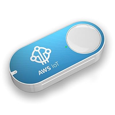

Hardware wise, are these any different then the Amazon Dash buttons?
Same hardware, which also means that the battery is only intended to last for 1000 presses and it is not in anyway replaceable. That’s why these buttons aren’t quite as cheap as they appear to be relative to other buttons – – the battery is soldered in place.
How long will the battery last?
The battery should last for approximately 1,000 presses. When the device battery runs out of charge, there is no way to recharge or replace the battery.
That said, the firmware is somewhat different as each button has its own ID which is what allows you to use it with the Amazon cloud. I don’t think there’s anyway to repurpose a regular Dash button to do what this does as it won’t have a known ID. ( Community members have repurposed them in other ways but not as a device that the Amazon cloud recognizes.)
They’re intended for IOT prototyping, not full-scale HA use.
the “regular” branded IOT buttons require you to run a script on some kind of local always on device like a pi or something comparable to listen for it’s ARP requests, this is well documented elsewhere and works quite well in my experience, lets you point it to the same ST urls.
short version is you set it up to work with your wifi with the amazon app, and simply don’t pick an actual product to order, when pressing the button it gets on your wireless and goes nowhere so the trigger has to be local.
