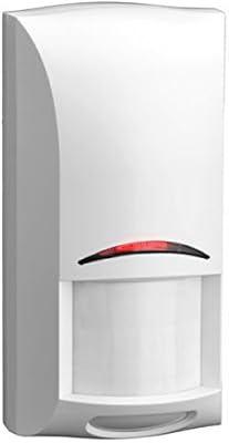

I used to had issue with false alarm. Mine was not due to flying bugs. Mine is mostly due to cloud. I have so many issue during the day and summer season. Try to pay attention whether you are experiencing this the false alarm in the dark of night. If you do not have any issue at night, Look for the BOSCH that has tritech. It is not the one you mentioned in the link. I have good luck eliminating the false alarm with this sensor. Take a look at this thread.

Like “iharyadi” said, I also used to have this problem. My SmartThings PIR motion sensor was installed outside above my house door but in a weather covered area and it would very often get false positives. I was about to give up on this until I came across the Bosch motion sensor, specifically the “Tritech” which has both the PIR sensor AND the traditional sensor that senses mass such as your typical outdoor security light motion sensor.
The PIR sensor alone is way too sensitive to pretty much everything that is outdoor, so this motion sensor has an additional sensor that is not PIR so in order to trigger, both built-in sensor types must be positive. Here’s a link the that sensor for Amazon. Trust me, don’t pay attention to the 3-star review. It took me a while to made up my mind on this sensor due to Amazon 3 star review, BUT I am so glad I bought it!
