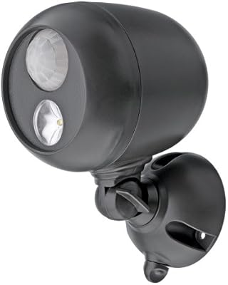

To be honest, if all you want to do is have a light came on when there’s motion near the door, just use a nonnetworked device like Mr. Beams. These work great.
They have several different sizes and shapes and degrees of brightness. We use these as path lights around the exterior of the house.
They won’t tie into SmartThings, but you may not need them to.
