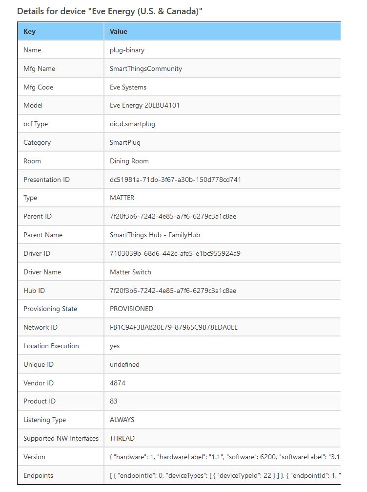

Update on Matter over Thread support on Samsung Refrigerator Smartthings Family Hub with Dongle
Ordered the Eve Matter over Thread smart plug and received it the same day (how Amazon does that I’ll never understand). When I plugged it in, my ST app detected it and prompted me to install it. Proceeding, I was prompted to scan the QR code after which I was presented with a “Get Started” prompt. It churned for a short time and then asked me to select my Thread network. None of the ones listed were anything I recognized and all required a network key. Couldn’t proceed forward from there.
Ok, so abort the install and try again. Scanning the QR code got me to the Preparing page, but it said the device was not discoverable. So, I unplugged it and started over. Same process as previously and got to the same page to select my Thread network where I was stuck again.
Since I didn’t see anywhere in the app or via the APIs (via the CLI) where a Thread network name is exposed much less a network key, I’m suspected that something is going on with the ST Family Hub. Checking the API Browser+, I found that Thread was no longer enabled on my hub dongle (thanks for the updated hub detail @TAustin). The hub had gone offline earlier in the day and I simply turned Wi-fi off/on to get it back online. Don’t know if that caused the Thread issue or not.
I did a soft reset/reboot of the Family Hub and after that, Thread support was available again. Unplugged the smart plug and restarted the install process and it proceeded without issue and I was never prompted for any Thread network name. I can control the smart plug from the ST app and from the my.smartthings.com site. I presume the Family Hub is serving as a TBR since the fridge communicates with the outside world via Wi-FI and the smart plug is on Thread.
In general, I think this would have been a simple and straightforward install if my hub had not been in a funky state where Thread support was disabled for some reason. That being said, I have a fair amount of experience with ST now and were the same situation to occur for a less experienced individual, it could have been a very frustrating installation experience.
Nothing special about this smart plug as it seems to simply support on/off. Even though the device is named “Eve Energy”, there are no energy metrics exposed in the ST app.
