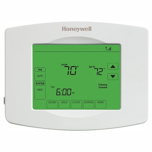

Those would be 2 of the " entry level " that I mentioned that would end up being free or less after $100 utility rebate. Honeywell also has WiFi and Z-Wave models without all the bells and whistles currently under $100
