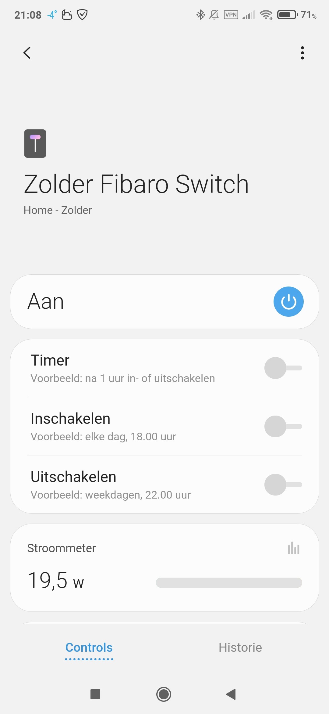

In the app, go to the settings of the RGB dimmer by the 3 dots in the upper righthand corner.

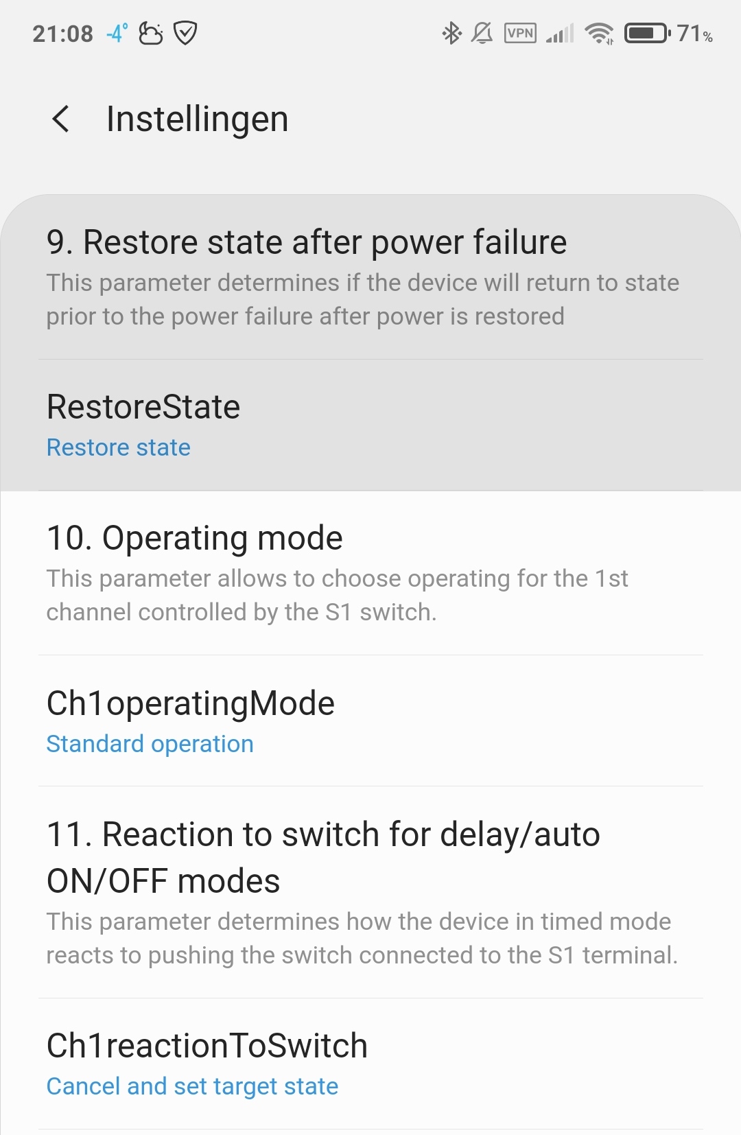

Here an example of my Fibaro Switch 2. See the option for the “Restore state after power failure”.
Grtn Ben
Setting 20 “Switch type”, change that for a test of switch type.
