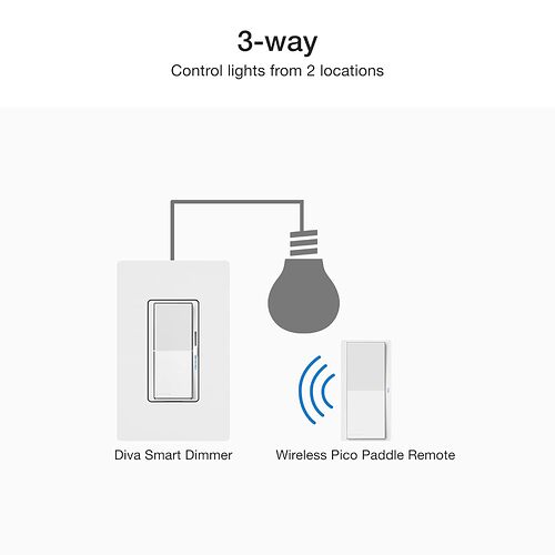

The graphic talks about having a wireless switch instead of hardwiring a traditional 3 way, but I don’t follow with what hardware this implies. Are they talking about using what looks like just a remote (fix it to the wall?) or do they sell a switch the mounts to the wall that houses a button off a battery (no wiring)

When it comes to using a three-way, Lutron gives you two choices.
They offer a line of battery powered remotes, which can either be handheld, on a tabletop stand, or fixed to the wall in a way that they will look like one of their wired switches. Battery life is great on these, typically 8 to 10 years. (Like I said, this is an engineering company.) The original were called “pico“. The new style is called “pico paddle.” So that’s what most people, including me, use. For example, they offer a “dimmer kit“ which includes one dimmer switch and one pico.

The remote seems like a great idea if you didn’t have existing wiring but for a new home build, wouldn’t you just have them install the accessory one for the 3-way, as if anyone ever wanted to remove the smart switch down the road, obviously that’s a problem if you only used the Picos?
Lutron is very fast. There may be a slight speed improvement with a direct wired accessory, but I doubt if it would be noticeable. For me, being able to dim from the accessory position is well worth it.
As far as worrying about what would happen in some distant future when you sold the house, if it bothers you, just remove the accessory and leave it as a single position switch. Or if it’s a new build, have the house wired for a dumb accessory in that position, And then you can use whichever one you prefer.
(Lutron offers a fitting that you can use to replace the dumb switch so that the pico is recessed into the wall if you like that look better. Or you can just use a blank plate there.) The point is that the wiring shouldn’t be an impediment, you can do it however you want.
