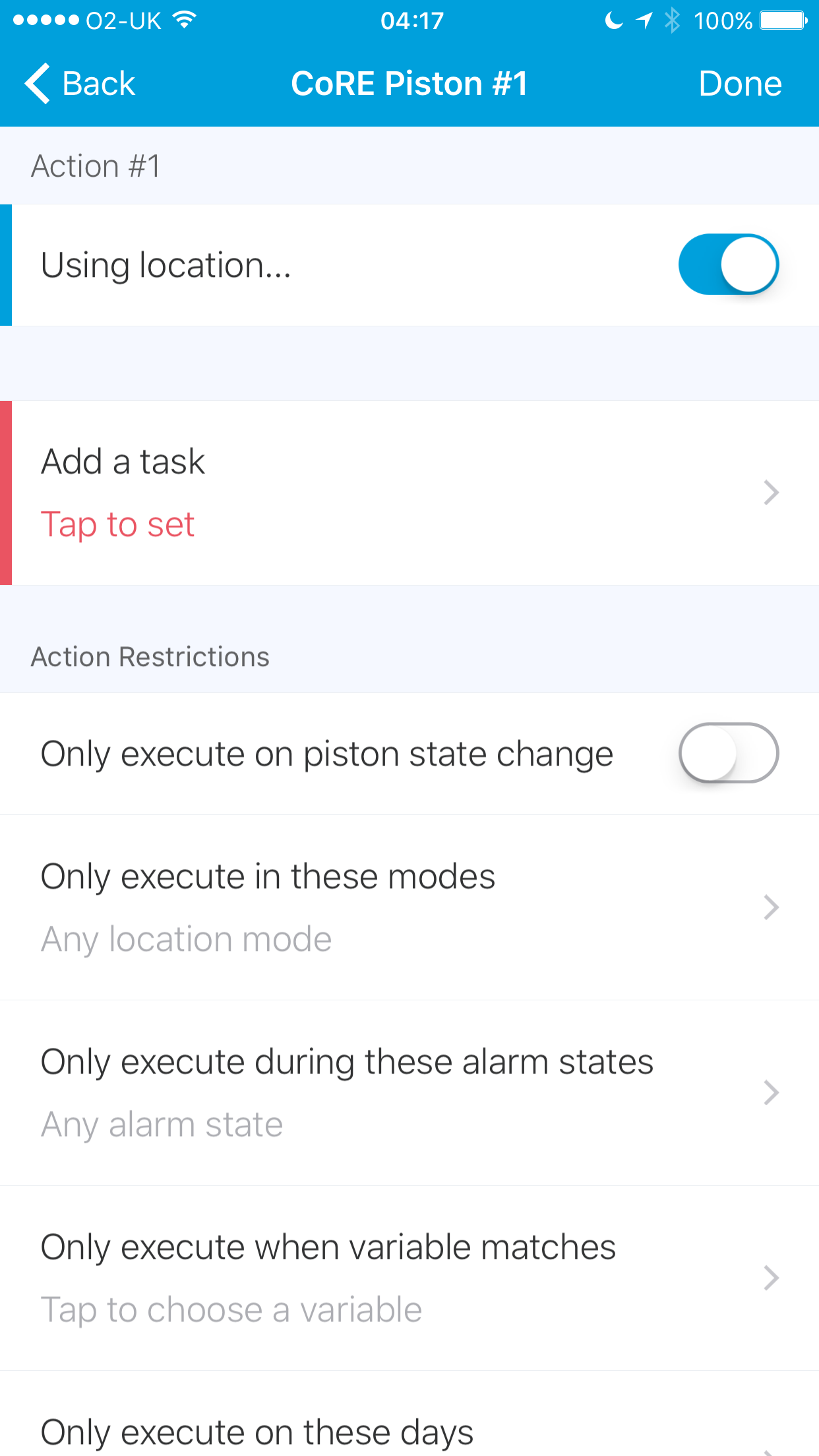

Hi SSShake.
You can control routines from CoRE - in your action block:
rather than a device (Office Bright in the example) select the slider “Using location” in CoRe, then select “Execute routine” - this will pop up a list of your existing routines.
Cheers
Matt
Wow thanks for the screenshots! Got it set up now.
This is actually a lot cleaner since I can just have one switch instead of multiple for each set of devices i want to control
