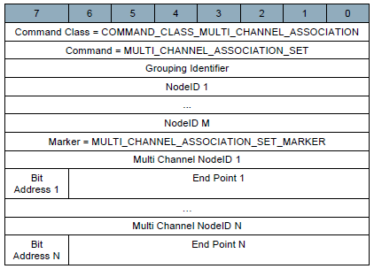

If we compare the raw command string you posted above “8E0101000101” (which is six bytes) to the COMMAND_CLASS_MULTI_CHANNEL_ASSOCIATION definition in the Z-Wave Public Spec doc [SDS12657-12]
…we can determine the meaning of each byte:
  • 0x8E = COMMAND_CLASS_MULTI_CHANNEL_ASSOCIATION
  • 0x01 = MULTI_CHANNEL_ASSOCIATION_SET
  • 0x01 = Grouping Identifier for Assoc Group #1
    [there are no nodeIDs]
  • 0x00 = MULTI_CHANNEL_ASSOCIATION_SET_MARKER, this is confirmed in [SDS13740]
  • 0x01 = Node #1
  • 0x01 = BitAddress of 0 and EndPoint #1.

We can see that each node added to the nodeId value corresponds to another byte on the end of the raw command. So the solution is simple, the nodeId attribute needs to be list of nodeIds, followed by a zero (the marker), and then pairs of nodeIds and EndpointIds :joy: E.g.:
// Add node #3 and endpoints [node:4,endpoint5] and [node:6,endpoint7] to assocation group #2:
cmds << zwave.multiChannelAssociationV2.multiChannelAssociationSet(groupingIdentifier: 2, nodeId: [3,0,4,5,6,7]).format() // == "8E0102030004050607".
