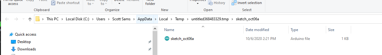

Is this not where they should be?
oddly though when I do select Sketch, View Sketch Folder it shows this one. Is that correct?
I am not sure how your “OneDrive” folder is injected into the file path.
Forget clicking into the “Documents” folder using the left side pane in the Windows Explorer window. Instead, go to C:\Users\YOUR USERNAME\Documents\Arduino.
The path at the top should look like
