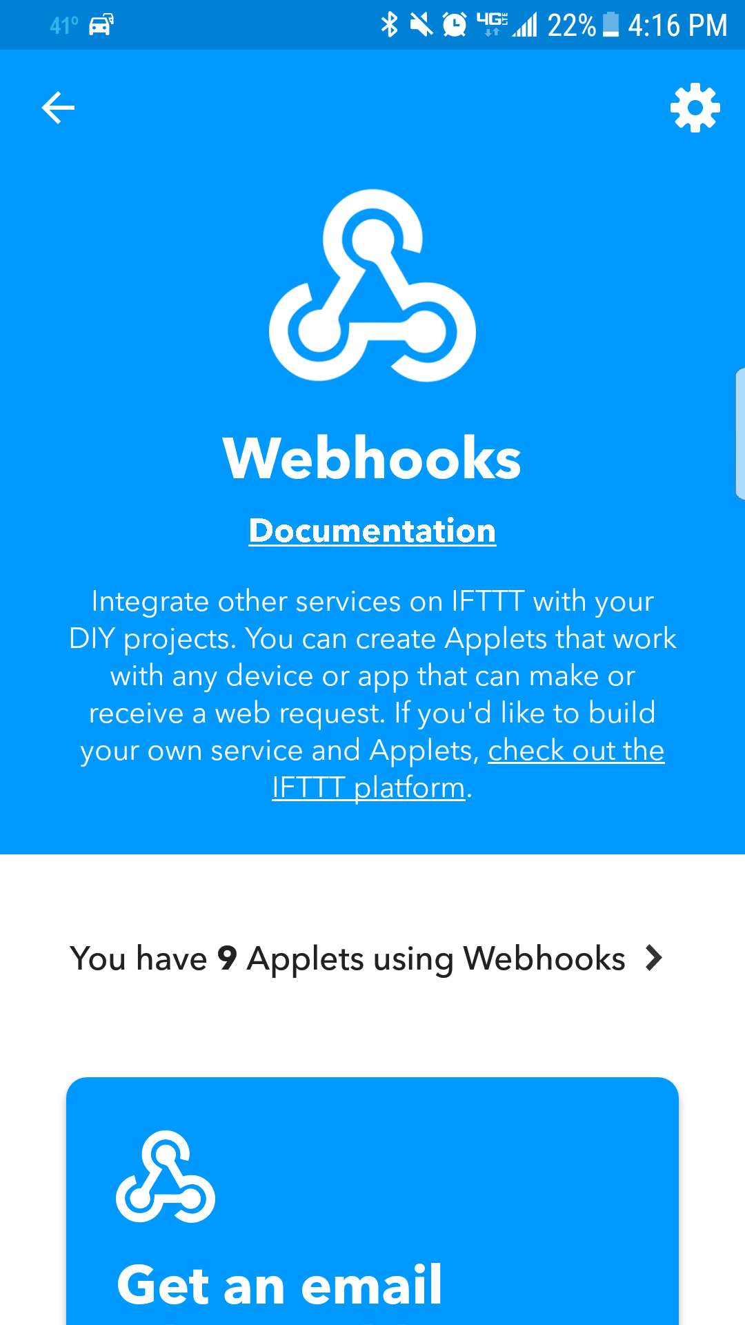

I tried using Webcore with webhooks to Ifttt but the response time from Ifttt was unacceptably slow. I modified a simulated minimote device type for this use.
It may just have been a bad day for Ifttt webhooks. I am planning to test again this weekend.
Would you please provide info on how to do this? Thanks.
I am not an app developer so please bear with my not so great directions. You need to go into Smartthings github repository and find the simulated minimote device handler. Copy the code. Next create a new device handler in your ide using the code you copy. Before saving and publishing the device handler, look through the code and change the label name for the buttons to something appropriate for your use case. (I don’t recall exactly which label I changed. I went through some trial and error to get it how I wanted it.) Now save and publish the device handler. Next, create a new device utilizing the device handler you just created. Once created, I exposed the device to Webcore and used a piston to send webhooks to Ifttt.
