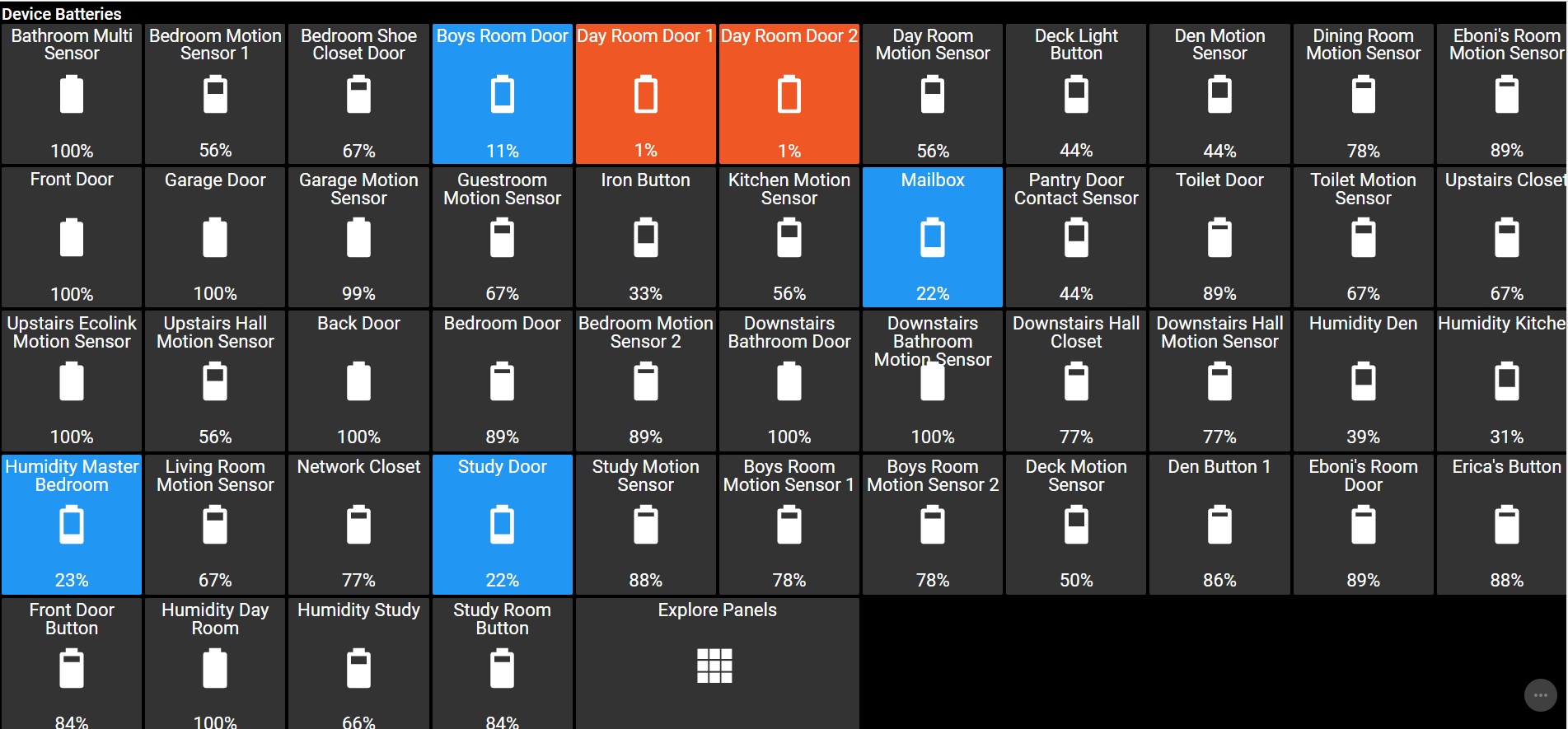

I still have a bunch of sensors with batteries that I am constantly changing. Wish I could hard wire them all but if they last for at least 9 months then I am ok with that.
Holy cow, that’s a lot of battery powered sensors! Sounds like you might be just the person to ask about them. Do you have a sensor of choice for different things (motion, doors, etc?).

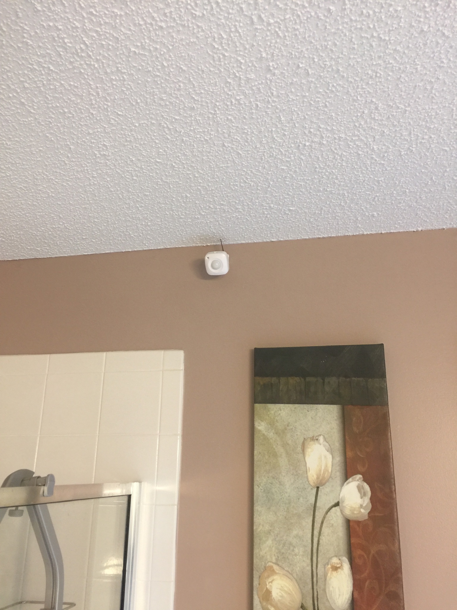

I can attest to this. I installed a Zooz 4 in 1 in my bathroom over a month ago to measure humidity and control the bathroom fan. It has the CR123A battery. As of this date the battery level still reads 100%! The humidity control works great. I am using it with a DTH from @krlaframboise.
I am using a Webcore piston similar to the one posted by @rontalley above. The current settings that seem to work now (in San Antonio Tx) are… turn on fan upon a rise in relative humidity above 55%. Turn off fan upon a drop in relative humidity below 54%. Turn off fan if fan stays on for 30 minutes for any reason. I may have to adjust the setpoints during the winter months. We will see.
