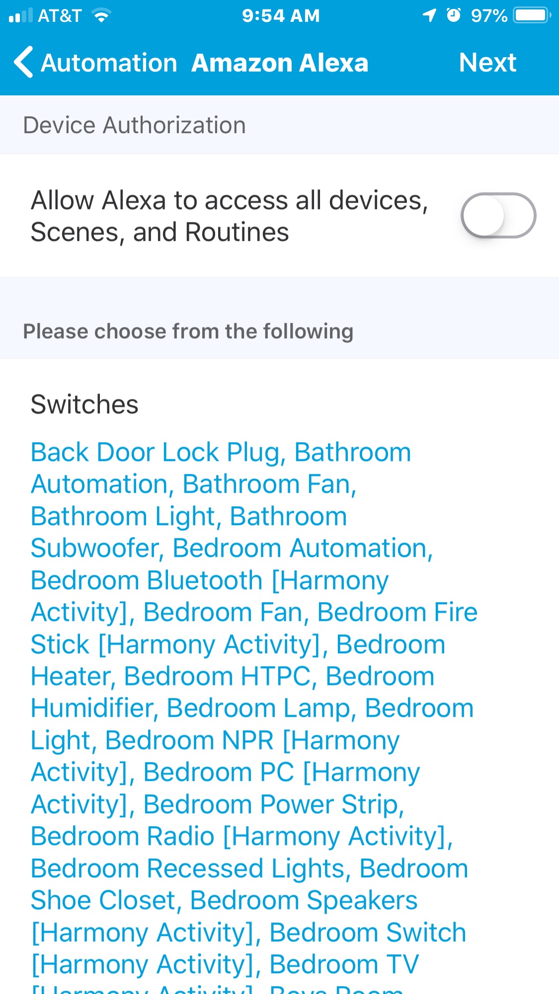

I have this similar scenario. I have 4 Harmony hubs, Amazon Echo/Alexa devices in every room as well as obviously, a SmartThings hub. I have the Harmony service connected to SmartThings and within SmartThings I see the activities as switches, as well as all the Harmony Hubs in their appropriate rooms. They are controllable in the SmartThings apps (old and new). In the SmartThings web interface, I can look at the Alexa service and see all the activities listed as service there. However, when I follow the next step of discovering new devices in Alexa, it finds none of them and as such they are not available for voice control or routines. Has anyone seen this variant?
Have you opened the Alexa App in SmartThings and selected the Harmony (Switches) as authorized devices?
Unfortunately, yes.
Are you saying, “Alexa, turn on watch a movie” or “Alexa, watch a movie” ?
You could also try logging out of the Alexa App and then back in.
The activities themselves are not discovered in the Alexa app. When I say Alexa, turn on watch kitchen tv, Alexa responds I could not find a device or group called kitchen tv in Barry’s profile. I also did log out of my Alexa app and back in as well.
