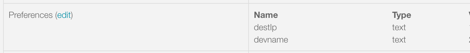

Click My Devices and select New Device
3.Name of your Haiku Fan.
4.Network id: enter the ip address of Haiku Fan (It’s in Haiku App Fan Configuration)
5.Type: Haiku Fan Control
Select your Location, Hub and Create it
7.Open the Device you have created above.
Preferences (edit)
Name Type Value
destIp text 192 IP address
devname text MAC Address
try below, Once above is done.
Under Things, tap Add a Thing
The app should say Looking for devices and it should list your Haiku device.
