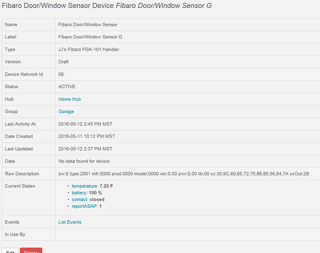

Here is the device info screen. I did notice the version is Draft. Am I supposed to change that manually or is that a symptom?
I’ll wait an hour and post the logs from the bottom of the device handler page then post the Event List logs in a few hours.
What will happen is that there will be no updates to the UI on the phone. Maybe the logs will show something. Is there some trick for posting the log trace or do I just copy the text and paste it in a message?

Here is the device log with “all” selected (This is a current screen. I separated out the entries for easier readability):
DateSourceTypeNameValueUserDisplayed TextChanged
2016-05-12 2:48:27.263 PM MST
7 hours ago DEVICE ENTITY_UPDATEDeviceUpdated false
2016-05-12 2:48:26.436 PM MST
7 hours ago DEVICE reportASAP 1 Fibaro Door/Window Sensor G report asap is 1 true
2016-05-12 2:37:23.857 PM MST
2016-05-12 2:37:23.800 PM MST
2016-05-12 2:33:00.947 PM MST
7 hours ago DEVICE temperature 7.25 Fibaro Door/Window Sensor G temperature is 7.25°F true
2016-05-12 2:28:47.254 PM MST
7 hours ago DEVICE temperature 5.68 Fibaro Door/Window Sensor G temperature is 5.68°F true
2016-05-12 2:24:33.558 PM MST
7 hours ago DEVICE temperature 3.78 Fibaro Door/Window Sensor G temperature is 3.78°F true
2016-05-12 2:20:19.631 PM MST
7 hours ago DEVICE temperature 1.74 Fibaro Door/Window Sensor G temperature is 1.74°F true
2016-05-12 2:16:05.625 PM MST
8 hours ago DEVICE temperature -0.40 Fibaro Door/Window Sensor G temperature is -0.40°F true

@Woo Fred Chavez
Thanks a lot for all the traces, I believe I understand now what happens.
The good news is that you did nothing wrong and properly installed my custom handler.
The bad news is that you must have either a v2 Hub or a more advanced version of the Fibaro FGK-101 device, or both : the “Parsed Crc16Encap(…)” you see in the IDE trace shows that the Z-Wave exchanges between your Hub and your Fibaro FGK-101 Device are now CRC16 encoded, which they were NOT for my own 13 units of FGK-101.
And since my handler does not currently support this encoding, most of the exchanges fail to be effective
This is actually confirmed by the “Raw Description” shawn for your FGK-101 Device, which ends with “86 80 56 84 7A” while mine ends only with : “86 80 84 7A” : the additional 56 capability is the CRC_16_ENCAP capability.
I will look into it and try to find a way to correct this encoding problem. But it is complicated by the fact that I have neither a v2 Hub, nor your (more advanced ?) version of the FGK-101. So any correction I do would be “blind” and could only be tested remotely by you…
…which could necessitate quite a number of iterations.
I will come back to you within 72h, after I have looked somewhat into this issue.
