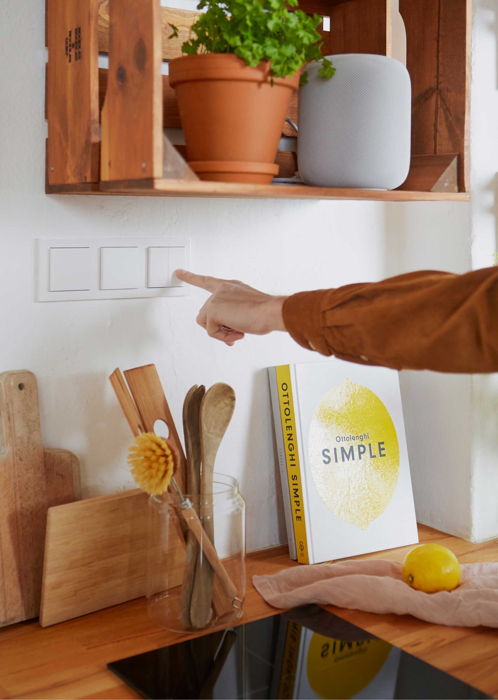

If you are willing to also get a Hue bridge, and the smart bulbs to be controlled by the switch also work with a hue bridge, you will have a couple of easy options in Italy.
First, right now you can get a Friends of Hue batteryfree switch and put it in place of the existing switch. These are made by several different manufacturers, including Vimar and Senic. These work well as a parallel means of control and look like regular switches. The switch itself will be visible in hue hue app but will not be visible to smartthings. But the bulbs themselves will be visible to smartthings. So you can control the bulbs from regulars smartthings automations, and you have a nice wall switch that will not cut power to the bulbs. These are also available in single gang or double gang EU style.
Here are the Senic models, although again they are available from a number of different companies.
No wiring is required, but they also don’t need batteries because they operate on the “Zigbee green power“ profile which harvests a tiny bit of energy just from you physically pushing the switch.
If you happen to use an iPhone, they can also be set up with Homekit as long as they are communicating to the Hue Bridge.
So this is a simple and straightforward way to get a wall switch for any smart lights which are using a hue bridge. And those same lights can also be controlled from smartthings.
