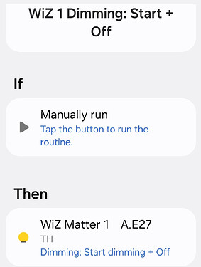

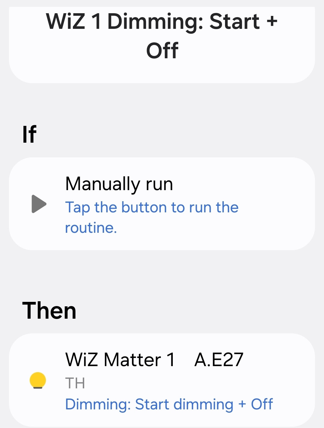

A few additional tips for using brightening and dimming
Configurable 0% to 100% time is set using setting
Possible selections for Dimming action
All these brightening and dimming functions are using configurable 0% to 100% time
@mocelet You can correct if my tips are not correct.
Thanks for the screenshots @TapioX , you saved me some work :grin: . That’s indeed how smooth dimming goes.
Full dimming time in settings
That’s how long it takes from maximum brightness to minimum. By default is 5 seconds which is a good value. I personally use 4 seconds which mimics the native remotes of my lights. Lower is hard to achieve accurate control.
