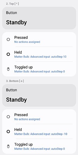

While this custom driver offers native start/stop smooth dimming for Matter lights, some bulbs like Nanoleaf or LIFX will flood the hub and the automation to stop the dimming will never run on time.
For fans of the start / stop behaviour I’ve implemented an auto-step feature so you don’t need other workarounds like buttons with auto-repeat Held or the virtual scene switcher.
It’s an Advanced input routine action:
  • autoStep 10 starts brightening at 10% steps
  • autoStep 0 stops
  • autoStep -10 starts dimming at 10% steps
Would look like this, Toggled up being whatever your button uses for the held Release:
