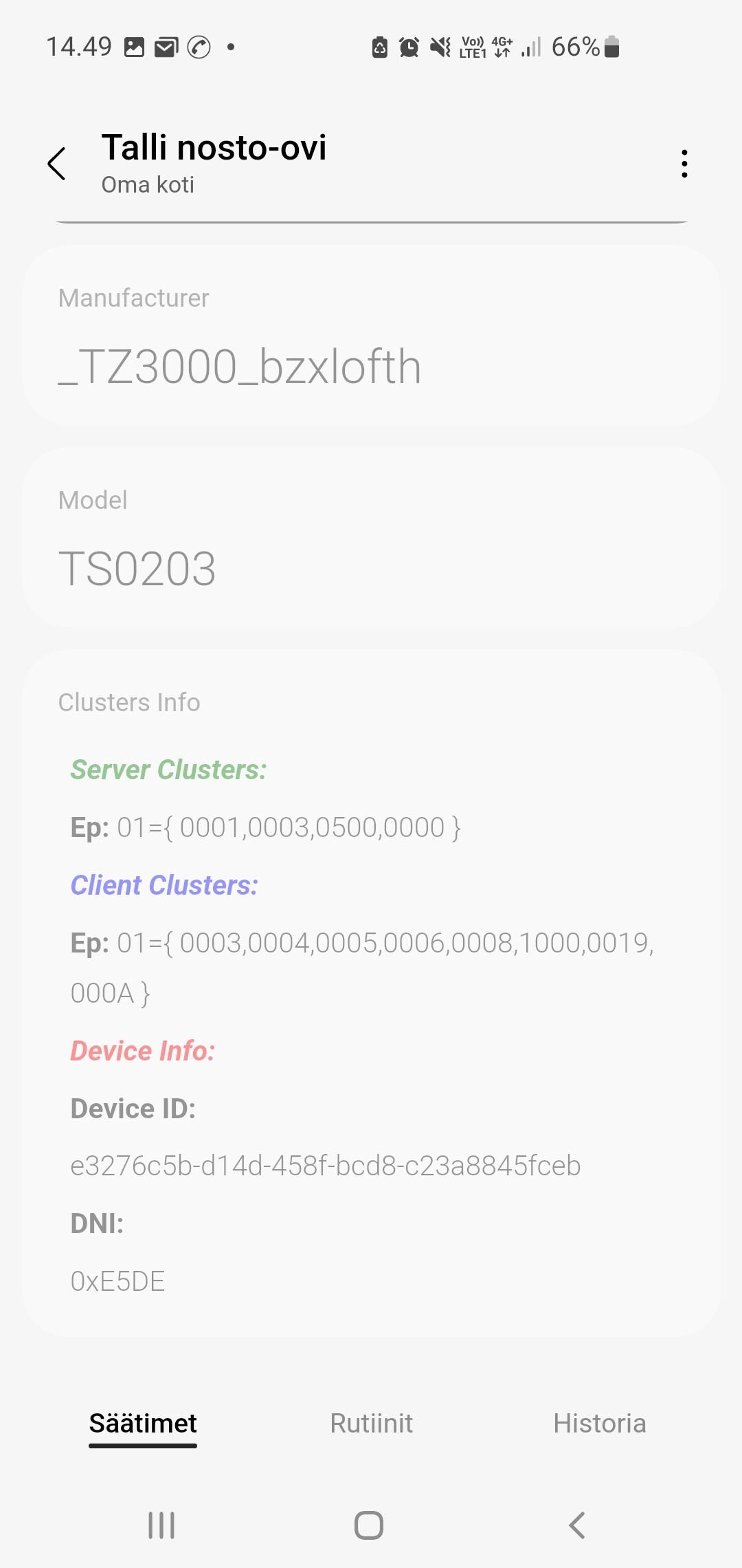

I just want to say a big thank you, Mariano for the good work done so far. Could you kindly add the following fingerprint to the zigbee switch power driver?
manufacturer: _TZ3000_okaz9tjs
model: TS011F
zigbeeNodeType: ROUTER
Raw Description: 01 0104 0051 01 08 0000 0006 0003 0004 0005 E001 0B04 0702 00
Could you add this. Basic magnetiv door/window switch.
Best regards,
Kimmo Liias
Hi @Kimmo_Liias
Added to this driver version
 Name         Zigbee Contact Mc
 Version      2022-10-27T11:55:32.557095359
  - id: "_TYZB01_bzxlofth/Contact Sensor"
    deviceLabel: TS0203 Contact Sensor
    manufacturer: _TYZB01_bzxlofth
    model: TS0203
    deviceProfileName: contact-battery-profile
Great!
This is widely sold sensor in many countries.
