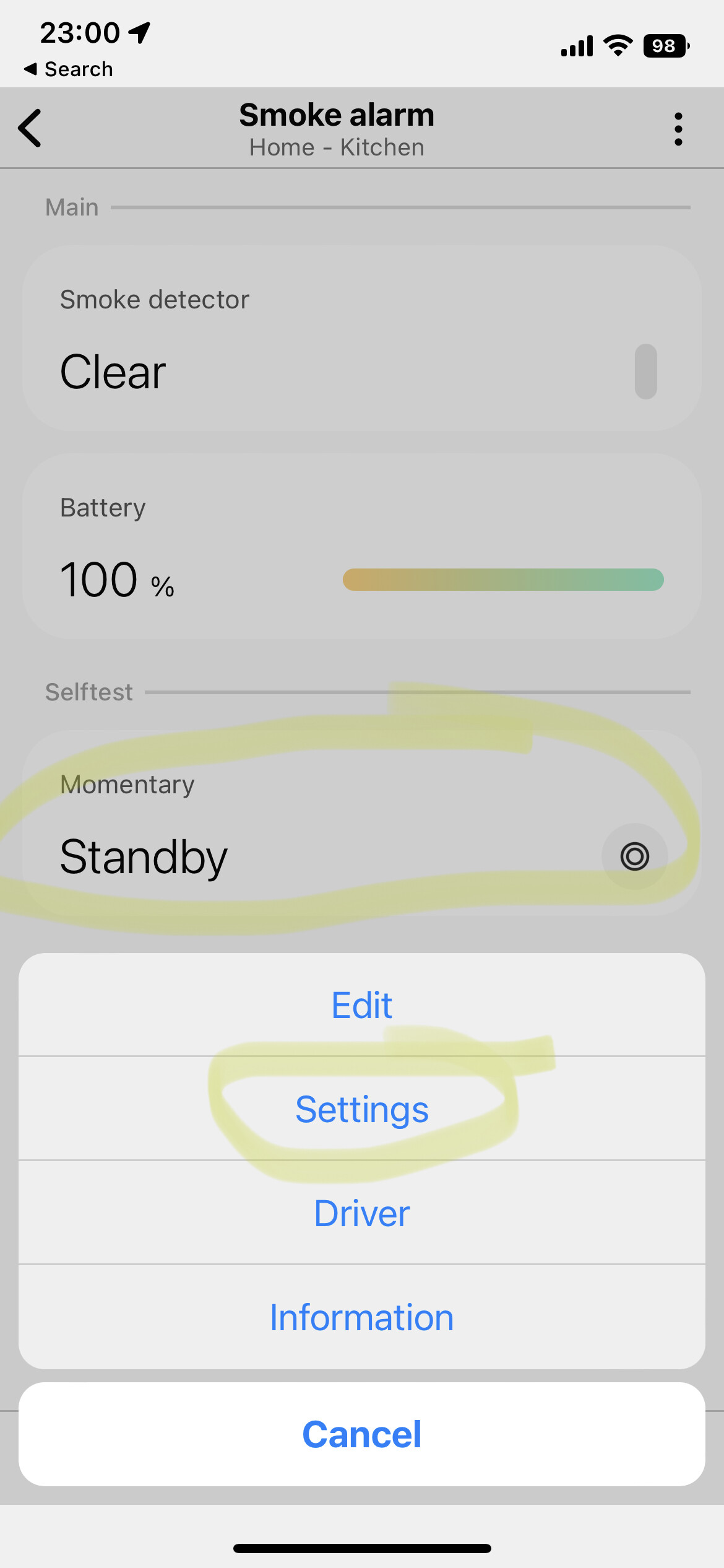

Tapping on the Softbutton in the “Momentary” section created this CLI log:
2022-10-16T21:23:21.620231699+00:00 TRACE Zigbee Water Leak/Smoke Sensor 1.4  Received event with handler capability
2022-10-16T21:23:21.629327365+00:00 INFO Zigbee Water Leak/Smoke Sensor 1.4  <ZigbeeDevice: 65b076d2-e1d0-4060-b57e-cd9b6df43609 [0xF6A0] (Smart Smoke Detector)> received command: {"args":{},"capability":"momentary","command":"push","component":"selftest","positional_args":{}}
2022-10-16T21:23:21.635470699+00:00 TRACE Zigbee Water Leak/Smoke Sensor 1.4  Found CapabilityCommandDispatcher handler in xiaomi-water -> Smoke
2022-10-16T21:23:21.640725699+00:00 INFO Zigbee Water Leak/Smoke Sensor 1.4  selftest_handler
2022-10-16T21:23:21.646371032+00:00 ERROR Zigbee Water Leak/Smoke Sensor 1.4  Smart Smoke Detector thread encountered error: [string "st/dispatcher.lua"]:233: Error encountered while processing event for <ZigbeeDevice: 65b076d2-e1d0-4060-b57e-cd9b6df43609 [0xF6A0] (Smart Smoke Detector)>:
    arg1: table: 0x2743f48
[string "st/zigbee/cluster_base.lua"]:199: Error creating payload: Boolean value must be type boolean

Ok, got 1.5 and pressed the virtual “Momentary Button” and this was the output (minus the TRACE, DEBUG elements, as per request):
2022-10-17T17:29:27.077656532+00:00 INFO Zigbee Water Leak/Smoke Sensor 1.5  <ZigbeeDevice: 65b076d2-e1d0-4060-b57e-cd9b6df43609 [0xF6A0] (Smart Smoke Detector)> received command: {"args":{},"capability":"momentary","command":"push","component":"selftest","positional_args":{}}
2022-10-17T17:29:27.088921198+00:00 INFO Zigbee Water Leak/Smoke Sensor 1.5  selftest_handler
2022-10-17T17:29:27.094330198+00:00 INFO Zigbee Water Leak/Smoke Sensor 1.5  Ep#1 device_id:0x0402 profile_id:0x0104 model:'lumi.sensor_smoke.acn03' manufacturer:'LUMI' Client clusters:[OTAUpgrade, ] Server clusters:[Basic, IASZone, Identify, PowerConfiguration, ]
2022-10-17T17:29:27.118113198+00:00 INFO Zigbee Water Leak/Smoke Sensor 1.5  <ZigbeeDevice: 65b076d2-e1d0-4060-b57e-cd9b6df43609 [0xF6A0] (Smart Smoke Detector)> sending Zigbee message: < ZigbeeMessageTx || Uint16: 0x0000, < AddressHeader || src_addr: 0x0000, src_endpoint: 0x01, dest_addr: 0xF6A0, dest_endpoint: 0x01, profile: 0x0104, cluster: Groups >, < ZCLMessageBody || < ZCLHeader || frame_ctrl: 0x01, seqno: 0x00, ZCLCommandId: 0x02 >, < GetGroupMembership || group_list_length: 0x00 > > >
2022-10-17T17:29:27.131625865+00:00 INFO Zigbee Water Leak/Smoke Sensor 1.5  <ZigbeeDevice: 65b076d2-e1d0-4060-b57e-cd9b6df43609 [0xF6A0] (Smart Smoke Detector)> sending Zigbee message: < ZigbeeMessageTx || Uint16: 0x0000, < AddressHeader || src_addr: 0x0000, src_endpoint: 0x01, dest_addr: 0xF6A0, dest_endpoint: 0x01, profile: 0x0000, cluster: 0x0033 >, < ZDOMessageBody || < ZDOHeader || seqno: 0x00 >, < MgmtBindRequest || start_index: 0x00 > > >
2022-10-17T17:29:27.153121532+00:00 INFO Zigbee Water Leak/Smoke Sensor 1.5  <ZigbeeDevice: 65b076d2-e1d0-4060-b57e-cd9b6df43609 [0xF6A0] (Smart Smoke Detector)> sending Zigbee message: < ZigbeeMessageTx || Uint16: 0x0000, < AddressHeader || src_addr: 0x0000, src_endpoint: 0x01, dest_addr: 0xF6A0, dest_endpoint: 0x01, profile: 0x0104, cluster: 0xFCC0 >, < ZCLMessageBody || < ZCLHeader || frame_ctrl: 0x04, mfg_code: 0x115F, seqno: 0x00, ZCLCommandId: 0x00 >, < ReadAttribute || AttributeId: 0x013A > > >
2022-10-17T17:29:27.179120532+00:00 INFO Zigbee Water Leak/Smoke Sensor 1.5  <ZigbeeDevice: 65b076d2-e1d0-4060-b57e-cd9b6df43609 [0xF6A0] (Smart Smoke Detector)> sending Zigbee message: < ZigbeeMessageTx || Uint16: 0x0000, < AddressHeader || src_addr: 0x0000, src_endpoint: 0x01, dest_addr: 0xF6A0, dest_endpoint: 0x01, profile: 0x0104, cluster: 0xFCC0 >, < ZCLMessageBody || < ZCLHeader || frame_ctrl: 0x04, mfg_code: 0x115F, seqno: 0x00, ZCLCommandId: 0x00 >, < ReadAttribute || AttributeId: 0x013B > > >
2022-10-17T17:29:27.194541865+00:00 INFO Zigbee Water Leak/Smoke Sensor 1.5  <ZigbeeDevice: 65b076d2-e1d0-4060-b57e-cd9b6df43609 [0xF6A0] (Smart Smoke Detector)> sending Zigbee message: < ZigbeeMessageTx || Uint16: 0x0000, < AddressHeader || src_addr: 0x0000, src_endpoint: 0x01, dest_addr: 0xF6A0, dest_endpoint: 0x01, profile: 0x0104, cluster: 0xFCC0 >, < ZCLMessageBody || < ZCLHeader || frame_ctrl: 0x04, mfg_code: 0x115F, seqno: 0x00, ZCLCommandId: 0x00 >, < ReadAttribute || AttributeId: 0x013C > > >
2022-10-17T17:29:27.207950532+00:00 INFO Zigbee Water Leak/Smoke Sensor 1.5  <ZigbeeDevice: 65b076d2-e1d0-4060-b57e-cd9b6df43609 [0xF6A0] (Smart Smoke Detector)> sending Zigbee message: < ZigbeeMessageTx || Uint16: 0x0000, < AddressHeader || src_addr: 0x0000, src_endpoint: 0x01, dest_addr: 0xF6A0, dest_endpoint: 0x01, profile: 0x0104, cluster: 0xFCC0 >, < ZCLMessageBody || < ZCLHeader || frame_ctrl: 0x04, mfg_code: 0x115F, seqno: 0x00, ZCLCommandId: 0x00 >, < ReadAttribute || AttributeId: 0x013D > > >
2022-10-17T17:29:27.222013865+00:00 INFO Zigbee Water Leak/Smoke Sensor 1.5  <ZigbeeDevice: 65b076d2-e1d0-4060-b57e-cd9b6df43609 [0xF6A0] (Smart Smoke Detector)> sending Zigbee message: < ZigbeeMessageTx || Uint16: 0x0000, < AddressHeader || src_addr: 0x0000, src_endpoint: 0x01, dest_addr: 0xF6A0, dest_endpoint: 0x01, profile: 0x0104, cluster: 0xFCC0 >, < ZCLMessageBody || < ZCLHeader || frame_ctrl: 0x04, mfg_code: 0x115F, seqno: 0x00, ZCLCommandId: 0x00 >, < ReadAttribute || AttributeId: 0x0126 > > >
2022-10-17T17:29:27.246547532+00:00 INFO Zigbee Water Leak/Smoke Sensor 1.5  <ZigbeeDevice: 65b076d2-e1d0-4060-b57e-cd9b6df43609 [0xF6A0] (Smart Smoke Detector)> sending Zigbee message: < ZigbeeMessageTx || Uint16: 0x0000, < AddressHeader || src_addr: 0x0000, src_endpoint: 0x01, dest_addr: 0xF6A0, dest_endpoint: 0x01, profile: 0x0104, cluster: 0xFCC0 >, < ZCLMessageBody || < ZCLHeader || frame_ctrl: 0x04, mfg_code: 0x115F, seqno: 0x00, ZCLCommandId: 0x00 >, < ReadAttribute || AttributeId: 0x0146 > > >
2022-10-17T17:29:27.262764198+00:00 INFO Zigbee Water Leak/Smoke Sensor 1.5  <ZigbeeDevice: 65b076d2-e1d0-4060-b57e-cd9b6df43609 [0xF6A0] (Smart Smoke Detector)> sending Zigbee message: < ZigbeeMessageTx || Uint16: 0x0000, < AddressHeader || src_addr: 0x0000, src_endpoint: 0x01, dest_addr: 0xF6A0, dest_endpoint: 0x01, profile: 0x0104, cluster: 0xFCC0 >, < ZCLMessageBody || < ZCLHeader || frame_ctrl: 0x00, seqno: 0x00, ZCLCommandId: 0x06 >, < ConfigureReporting || < AttributeReportingConfiguration || direction: 0x00, attr_id: 0x013A, DataType: Uint8, minimum_reporting_interval: 0x001E, maximum_reporting_interval: 0x5460, reportable_change: 0x01 > > > >
2022-10-17T17:29:27.287495865+00:00 INFO Zigbee Water Leak/Smoke Sensor 1.5  <ZigbeeDevice: 65b076d2-e1d0-4060-b57e-cd9b6df43609 [0xF6A0] (Smart Smoke Detector)> sending Zigbee message: < ZigbeeMessageTx || Uint16: 0x0000, < AddressHeader || src_addr: 0x0000, src_endpoint: 0x01, dest_addr: 0xF6A0, dest_endpoint: 0x01, profile: 0x0104, cluster: 0xFCC0 >, < ZCLMessageBody || < ZCLHeader || frame_ctrl: 0x00, seqno: 0x00, ZCLCommandId: 0x06 >, < ConfigureReporting || < AttributeReportingConfiguration || direction: 0x00, attr_id: 0x013B, DataType: Uint8, minimum_reporting_interval: 0x001E, maximum_reporting_interval: 0x5460, reportable_change: 0x01 > > > >
2022-10-17T17:29:27.307938865+00:00 INFO Zigbee Water Leak/Smoke Sensor 1.5  <ZigbeeDevice: 65b076d2-e1d0-4060-b57e-cd9b6df43609 [0xF6A0] (Smart Smoke Detector)> sending Zigbee message: < ZigbeeMessageTx || Uint16: 0x0000, < AddressHeader || src_addr: 0x0000, src_endpoint: 0x01, dest_addr: 0xF6A0, dest_endpoint: 0x01, profile: 0x0104, cluster: 0xFCC0 >, < ZCLMessageBody || < ZCLHeader || frame_ctrl: 0x00, seqno: 0x00, ZCLCommandId: 0x06 >, < ConfigureReporting || < AttributeReportingConfiguration || direction: 0x00, attr_id: 0x013C, DataType: Uint8, minimum_reporting_interval: 0x001E, maximum_reporting_interval: 0x5460, reportable_change: 0x01 > > > >
2022-10-17T17:29:27.332446532+00:00 INFO Zigbee Water Leak/Smoke Sensor 1.5  <ZigbeeDevice: 65b076d2-e1d0-4060-b57e-cd9b6df43609 [0xF6A0] (Smart Smoke Detector)> sending Zigbee message: < ZigbeeMessageTx || Uint16: 0x0000, < AddressHeader || src_addr: 0x0000, src_endpoint: 0x01, dest_addr: 0xF6A0, dest_endpoint: 0x01, profile: 0x0104, cluster: 0xFCC0 >, < ZCLMessageBody || < ZCLHeader || frame_ctrl: 0x00, seqno: 0x00, ZCLCommandId: 0x06 >, < ConfigureReporting || < AttributeReportingConfiguration || direction: 0x00, attr_id: 0x013D, DataType: Uint8, minimum_reporting_interval: 0x001E, maximum_reporting_interval: 0x5460, reportable_change: 0x01 > > > >
2022-10-17T17:29:27.346555532+00:00 INFO Zigbee Water Leak/Smoke Sensor 1.5  <ZigbeeDevice: 65b076d2-e1d0-4060-b57e-cd9b6df43609 [0xF6A0] (Smart Smoke Detector)> sending Zigbee message: < ZigbeeMessageTx || Uint16: 0x0000, < AddressHeader || src_addr: 0x0000, src_endpoint: 0x01, dest_addr: 0xF6A0, dest_endpoint: 0x01, profile: 0x0104, cluster: 0xFCC0 >, < ZCLMessageBody || < ZCLHeader || frame_ctrl: 0x00, seqno: 0x00, ZCLCommandId: 0x06 >, < ConfigureReporting || < AttributeReportingConfiguration || direction: 0x00, attr_id: 0x0126, DataType: Uint8, minimum_reporting_interval: 0x001E, maximum_reporting_interval: 0x5460, reportable_change: 0x01 > > > >
2022-10-17T17:29:27.369311198+00:00 INFO Zigbee Water Leak/Smoke Sensor 1.5  <ZigbeeDevice: 65b076d2-e1d0-4060-b57e-cd9b6df43609 [0xF6A0] (Smart Smoke Detector)> sending Zigbee message: < ZigbeeMessageTx || Uint16: 0x0000, < AddressHeader || src_addr: 0x0000, src_endpoint: 0x01, dest_addr: 0xF6A0, dest_endpoint: 0x01, profile: 0x0104, cluster: 0xFCC0 >, < ZCLMessageBody || < ZCLHeader || frame_ctrl: 0x00, seqno: 0x00, ZCLCommandId: 0x06 >, < ConfigureReporting || < AttributeReportingConfiguration || direction: 0x00, attr_id: 0x0146, DataType: Uint8, minimum_reporting_interval: 0x001E, maximum_reporting_interval: 0x5460, reportable_change: 0x01 > > > >
2022-10-17T17:29:27.404307198+00:00 ERROR Zigbee Water Leak/Smoke Sensor 1.5  Smart Smoke Detector thread encountered error: [string "st/dispatcher.lua"]:233: Error encountered while processing event for <ZigbeeDevice: 65b076d2-e1d0-4060-b57e-cd9b6df43609 [0xF6A0] (Smart Smoke Detector)>:
    arg1: table: 0x1c2c748
[string "st/zigbee/cluster_base.lua"]:199: value and data_type for payload must be non-nil

1.6 Output when I hit the soft button “momentary” in 1.6:

try v1.7
for some reason, the device answered only on attributes 0x013A, 0x013B. and unsupported 0x0126
    + reporting(device, 0x013a, data_types.Uint16)
    + reporting(device, 0x013b, data_types.Uint8)
    reporting(device, 0x013c, data_types.Uint8)
    reporting(device, 0x013d, data_types.Uint8)
    --reporting(device, 0x0126) unsupported ?
    reporting(device, 0x0146, data_types.Uint8)
try to get all the attributes.
Also, after you get all more reports in normal mode try to trigger an alarm and see the reports in active mode.
Button press in 1.7:
