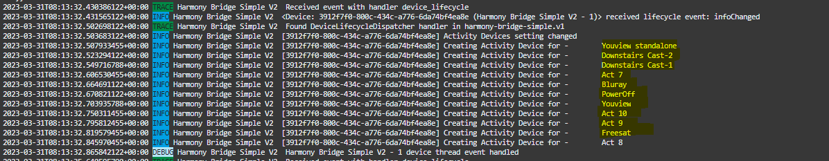

Following up, the team mentioned there’s no limit of 10 child devices and they have drivers where they are using 17 for example, so, something else must be going on.
We need to report this issue, so, @JEFFBUSSE, please share the following info:
As I understand, when you select a certain config, all child devices are created, right, @lmullineux?
If so, it would be helpful that you repeat this step to see why they don’t get created correctly and to get the driver logs of that process.
That can be done by setting up the CLI and running the command smartthings edge:drivers:logcat --hub-address=x.x.x.x --all > driverlog.log
Please let me know if you need help with this part
Send the Hub logs after repeating this process to see if something was registered there:
Select the time period and confirm - In this step, please select “Until turned off”, once the team finishes, we’ll let you know so you can disable it again.

This results in the following logs, the first 10 devices are created (highlighted yellow), but the 11th device is not created - there is no error
I’m not saying there is an overall limit of number of devices a driver can have, even this driver supports more than the 10 i mentioned. The limit seems to come in when the parent device id is set in the meta data - it seems like 1 parent can only have 10 children each when using this field.
