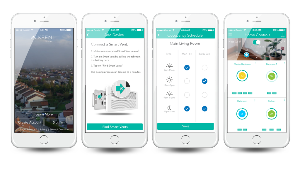

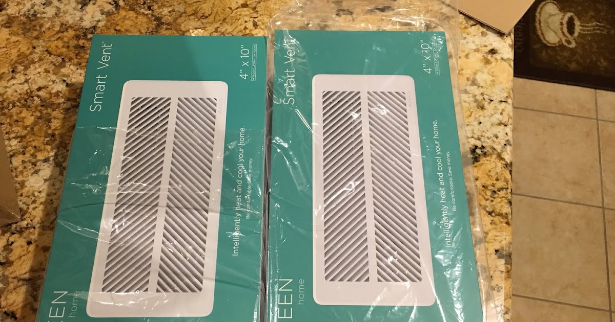

I had the opportunity to install both the Keen and Ecovent systems in my home and wrote a small blog post on them (my first)
Hope you find it useful
Please let me know if you have any questions on how either system works.

any chance you could review the native application functionality?
Appreciated, thanks

Well yea, there is the sales pitch, and there is the actuality.
I’ve read the blog, doesn’t mean the mentioned functionality works…
I mean we didn’t purchase these vents to have the privilege of adjusting them manually from our phones did we?
Mike,
Agree… i have been using the Auto mode with the bridge and have a setpoint set ± from the nest temp for different rooms as to how hot/cold they were before the vent install and for the most part the rooms are close to the Nest temp setpoint (using a handheld thermostat to verify)
Unfortunately, there is no detailed logging in the Keen app and unlike a zwave device, i cant add the vent to both ST & Keen hub to get the logs in ST to verify operation
I have set 2 rooms to close during night and when i check the vents in these rooms they appear to be closed, the temp is lower than the nest temp even when the Thermostat calls for heat and then they open again in the morning when the schedule in the Keen App dictates…
Oh, OK, do you/did you take a base line temp in these rooms prior to running the app to see what the before and after differences were?
Does the Keen app actually control the room temps accurately in relation to the zone offset settings that you configure?
You have to open and close the vents on a schedule?, I don’t understand the point of that, can you explain?
Mike,
I did do a manual base line, nothing fancy…
e.g. my Powder room would get to 74 deg with the Nest set to 70 (the manual vent was closed 3/4 of the way)
I added the Keen vent and set the temp to -4 and now the powder room stays close to 69 when the Nest is holding its temp at 70
