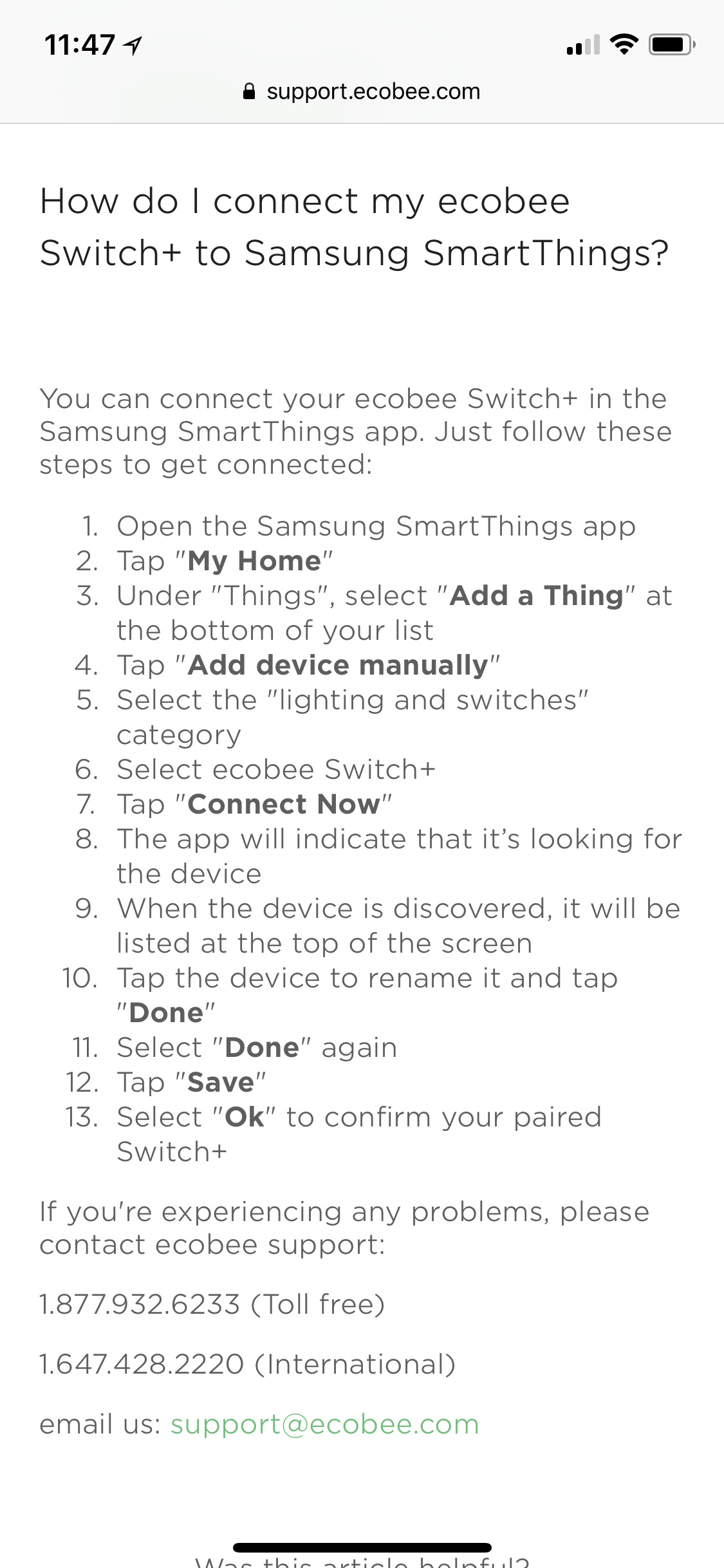

Anyone been able to add this to ST? On the ecobee support page it shows this, but I don’t have this option:

they clearly were not ready. I wonder if those instructions are for the new smarthings app, and not the smarthings classic app. I don’t have a “lighting and switches” category in the classic app
