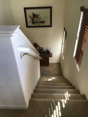

I have turned stairs that begin in an entry way. In the entry way is a Hue BR30 flood light (flush ceiling mounted.). At the top of the landing is a wall. I want to place the sensor on the wall so that it detects motion either coming up or going down the stairs. Because it’s turned stairs, the landing is between the flight from the 1st floor to the landing and the flight from the landing to the second floor. So, it’s pretty equidistant from either the top of the stairs or the bottom of the stairs. The light in t he entry way is bright enough to illuminate the entirely of the stairs when going up and down at night. Seems like a great use case. Doesn’t work well. The reason? I have to practically be on top of this sensor before it recognizes motion. I see that many people have mounted these above doorways. Frankly, I don’t see how, with the poor distance range os the sensor.

Did you ever resolve the issue? If not, I see a couple problems (I’m assuming by the photos, these are the latest generation ST motion sensors and not the 2015):
  1. as @JDRoberts noted, PIR sensors work best when an IR emitting source passes across the sensor field. So, you should actually be place the sensor more perpendicular to the entry point. So instead of the bottom and top of stairs head walls, you should be placing on the side walls or on a wall or ceiling which permits an IR emitting body to break pass across the sensor field, not straight on.
  2. one problem with your test, is that you are not taking into account the transmit time from motion sensor to hub to to light to trigger that event. The ST motion sensor also works on zigbee (2.4Ghz), so if there are interfering devices, etc., you might not get as quick of a response relaying the signal. Note that your other devices I am presuming are zwave devices, and a zigbee device does not operate on the zwave mesh network, so your other devices aren’t extending the mesh network to that zigbee device. The ST motion sensor, then, is on its own.
  3. Related to the test problem in point 2 is that your expectation of triggering the light is not realistic. You have a very short distance from sensor placement and stair entry. You are moving at a normal pace, so you probably won’t get the motion sensor to register motion, relay the signal to hub (zigbee), process zigbee to zwave, relay zwave signal to light to trigger on.
  4. You might also try disabling zigbee secure connect.
As far as what others report: I would almost bet that 90% of the people complaining about motion sensors simply do not understand how PIR sensors work. Even if you scan online videos of tech device reviewers, you will see a high number of them who do not understand how PIR sensors work.
I would recommend first trying the perpendicular mount outside of the stairway, but if in the stairway, then mount in the corners of the stairway or on the side wall at the entry points.
Thank you so much for the follow up and excellent information regarding the functioning of PIR sensors. It is always helpful to learn more about how certain devices work!
I actually just got back around to the project within the last day or two, so good timing for me to respond with how it is going.
I ended up returning the sensor I had and purchasing another. This time, I purchased a Hue sensor (since the vast majority of my lighting is Hue.) But I did install the custom device handler I found here in the community so I could control it in ST and more easily tap into the other functionality this sensor provides. In the last two days, I have tested that sensor in a variety of scenarios, including the one that I was having trouble with in my original post. All scenarios tested are working as expected. Hue lights and GE switches (connected to non Hue lights) trigger within a good time frame, while I am still at the bottom or the top of the stairs. I know it looks like a super short distance from top and/bottom of stairs to where I had placed the sensor, but the image is a little deceiving. It’s a good 10 feet from either. The placement (same as used for the previous sensor) provides some pretty good angling from either top or bottom (depending on where I’m standing) as well as side, so there’s never a straight on view when the motion is expected to be captured. I was aware that the ST sensor is a zigbee device, and as I do have other zigbee devices in my set up, I figured it wouldn’t have had any issues.
