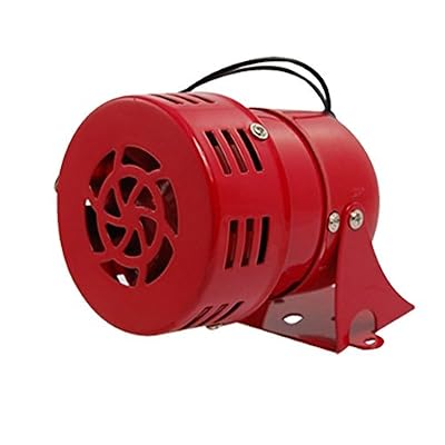

I’m traveling and i will install a powerful siren controlled by a z-wave switch and triggered by a motion sensor.

This is the siren
Hobbypower AC 220V Mini Motor Driven Air Raid Siren Horn For Car Truck Alarm MS-190

I could wake my entire neighborhood up with this. It would be terrifying. They also sell a 125db model. Ha.
