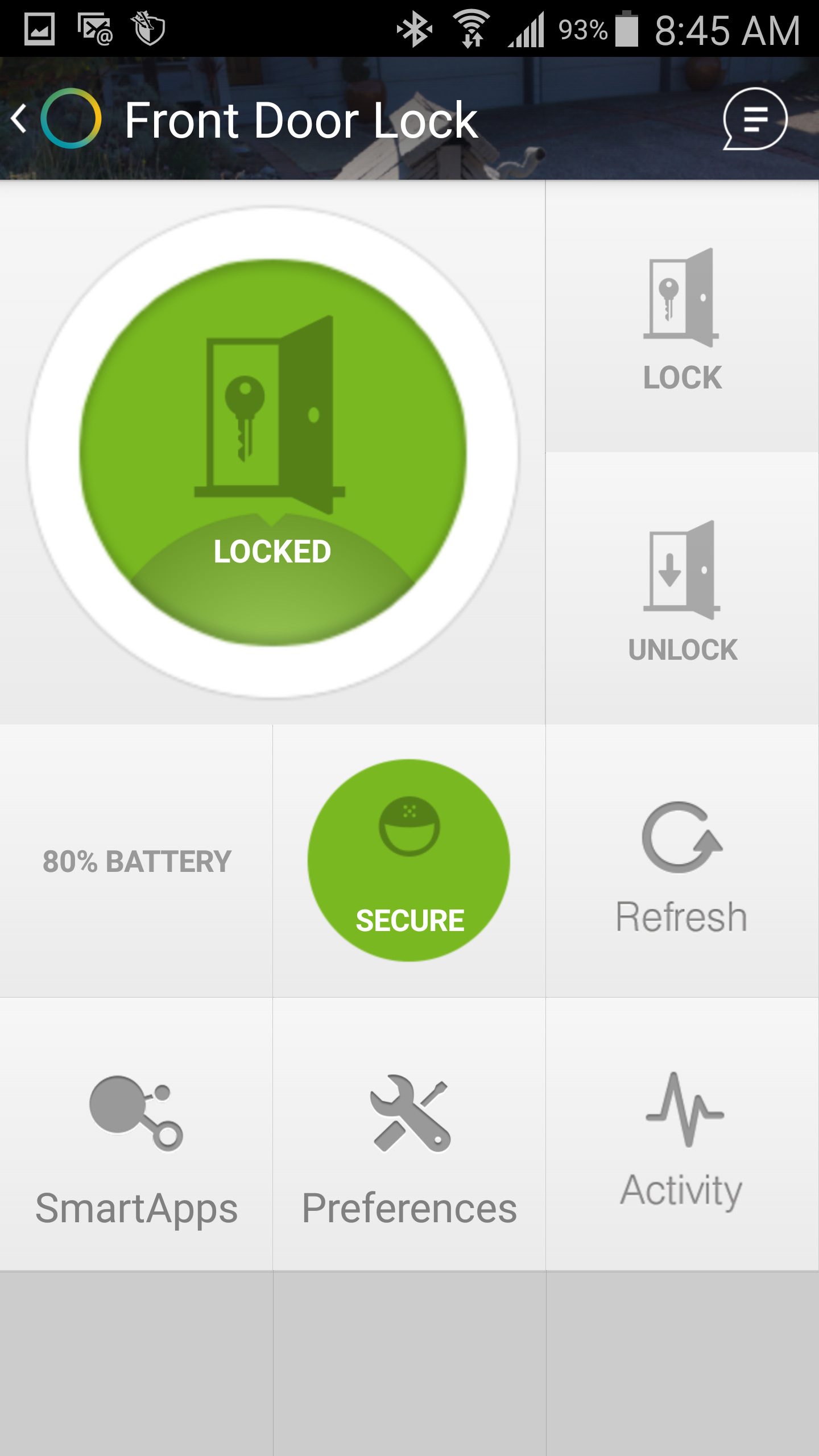

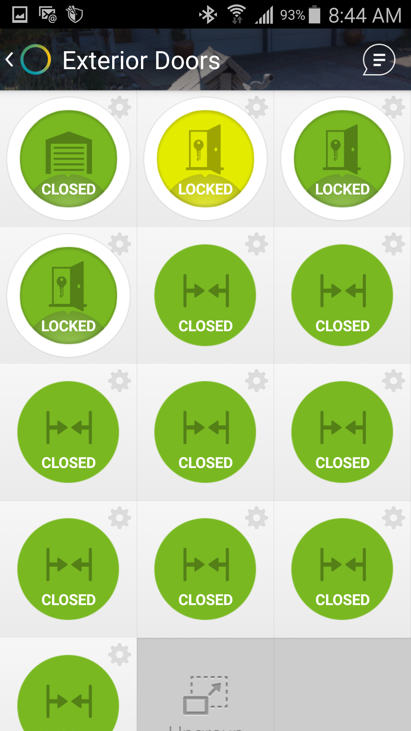

Normal state:
Someone is being naughty
But then we successfully unlock the door
And finally we clear the tamper by tapping it
