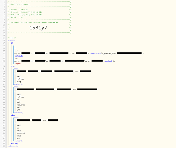

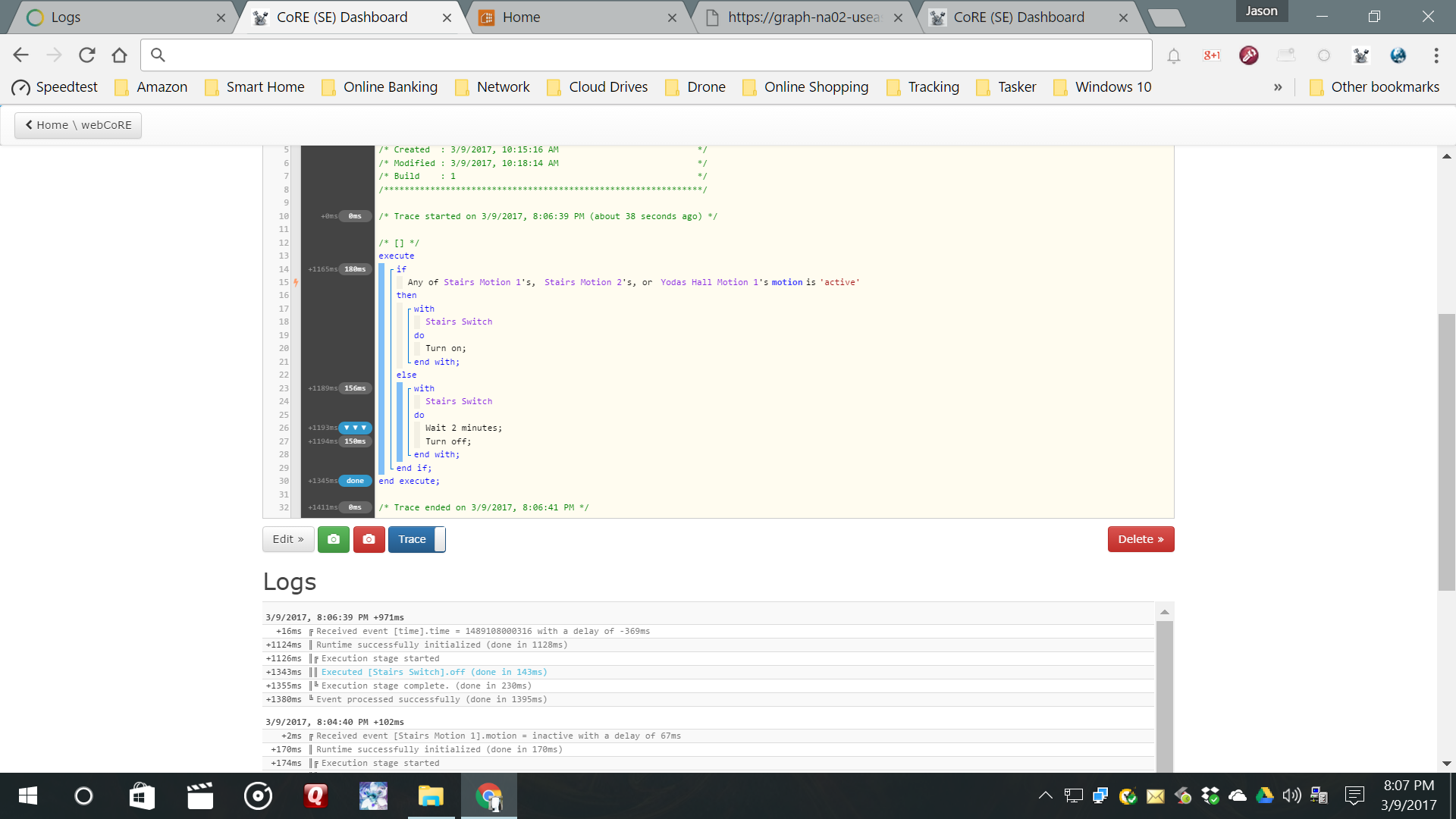

Ok @ady624, updated to the latest and with chrome did a clear cache and hard reload several times. I set up a test piston with some basic things. Couple of waits, refreshes, turn on, set level, turn off all mixed in. Do not see anything crazy popping up error wise. I really enjoy being able to whip up a ‘complex’ piston in a matter of moments just being able to click around.
Here is what I came up with so far.
nothing over the top. None of the waits exceed 5 seconds.

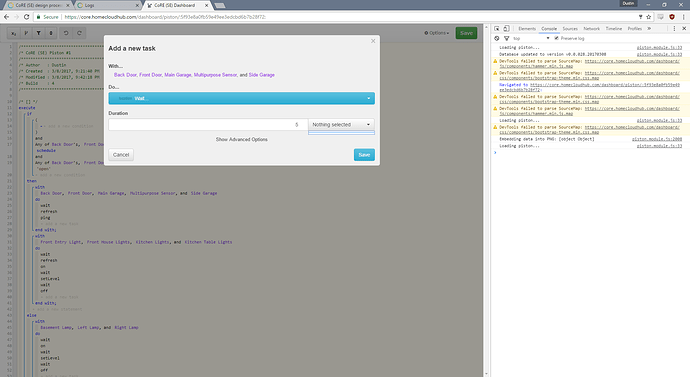

When I am selecting a wait time frame the list never drops down to display anything. I must use the arrow keys up and down to make a selection. It almost looks like the height of each one is only a couple pixels.
I was able to watch the trace a couple times but it seems incredibly finicky about when it likes to show up. I do not know if I am doing something wrong or what?
Lastly one thing I noticed is the graph is scalable… I am sure this is intentional but caught me off guard while trying to scroll down the page and my graph was getting tiny.
Yeah, the params are not initialized woth existing values (editing an old task does not reveal current values). The select shows those thin lines if a default value does not exist (will get that fixed) and the tasks only show their “name”, they need to start showing real text with parameters. Maybe I’ll get those done tomorrow night for now I am trying to get the execution to work.

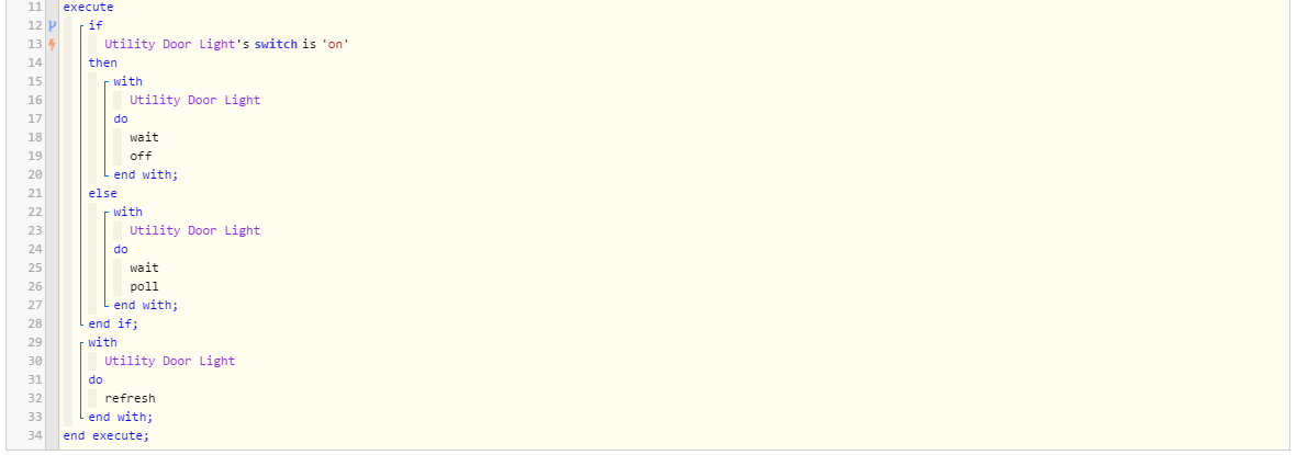

Reality check: Sync vs Async.
Using this piston in full sync mode:
What it does is, when the light turns on, it waits 10 seconds and then turns off the light and refreshes it. When the light turns off, it waits 10 seconds, runs a poll and then refreshes it.
Here are the traces:

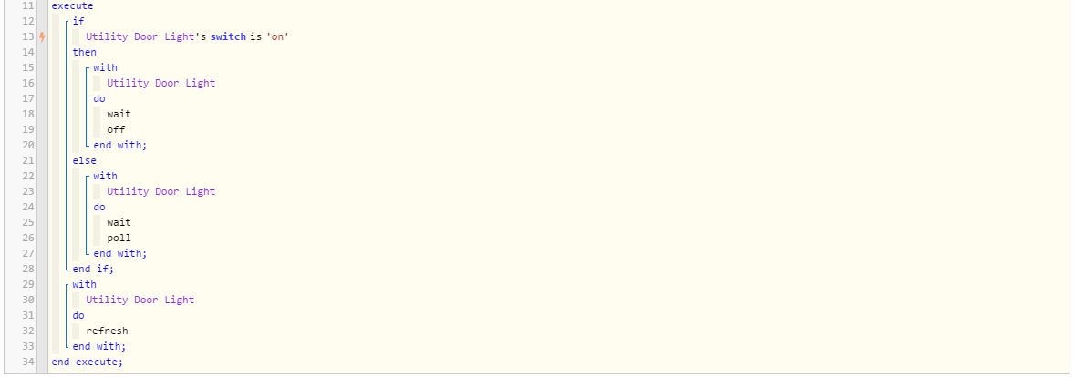

Now consider making the IF statement asynchronous, this means that it won’t interrupt the regular flow of the piston. So, click on the IF, click on advanced options, choose Asynchronous, save:
Note the little blue icon next to the if.
Here are the logs:

Notice how the refresh happened when the light turned on and off, without waiting the 10 seconds like it did the first time?
Is this making sense to anyone else?

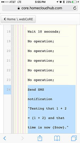

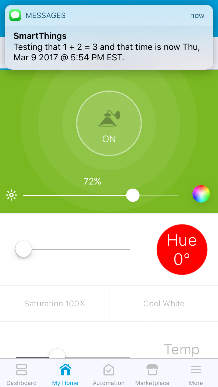

And it appears that 1 + 2 makes 3…
Update to latest, you need to edit all parameters please, they need to be reset, all of them.

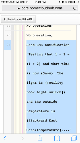

And using the celsius() function, it appears I need to set some default formatting for floats?
And the result:
And formatting it properly:
And the result:
