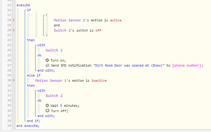

How can I make a motion sensor turn on my lights and then off after no activity??
I have created a monster lol
Dustin,
Here is how I do mine, it works just fine, however I am sure others have a cleaner way, until then, enjoy
Rick

The problem with this is that motion sensor 1 can become active again within those 5 minutes and you’ll turn off the light on someone in the room :slight_smile:
One way to avoid that is to set a global variable every time your sensor goes inactive for now() + 5 minutes and reset it every time sensor goes active. Then another event will trigger when now() > this variable. This way you keep pushing this time back every time a sensor goes active / inactive and only any lack of sensor activity will trigger your automatic light off routine.
Or alternatively, your line 36 should check if the motion sensor is still inactive before turning the light off. But it literally becomes too complicated to track this one piston - my understanding that multiple instances of it should be able to run in parallel to account for the wait. And what happens if motion becomes active while this piston is already waiting? Will another instance of this piston fire off? I mean this multitasking is just too complicated for an average user to think of, thus it’s much better and cleaner to split it into separate pistons - one takes care of motion and setting/clearing that separate 5 minute variable and another triggers when the variable expires.

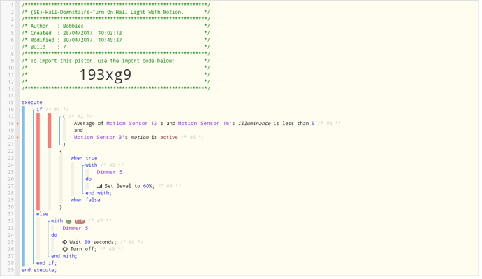

@Toy4Rick Thank you for the reply but I was making a joke from a previous thread about when this goes beta. Also it will be helpful to do like I mentioned above when sharing pistons. Click the green photo button and that will mask your piston and give everyone and import code so it can be quickly added to webCoRE.

Yes I am aware, haven’t had much luck in the past with capturing the piston once in the anonymizer in Win10 so a screen grab, edit in Paint was easier. Seems to be working now
Any chance I/we can get a sample Piston or 2 posted in the Sample Piston thread to work from?

It’s not even that you stay in that area for 5 minutes… Imagine you walked in, walked out. After some time motion stopped and your 5 minute counter started and you walk in a couple secs before the timer expires.
