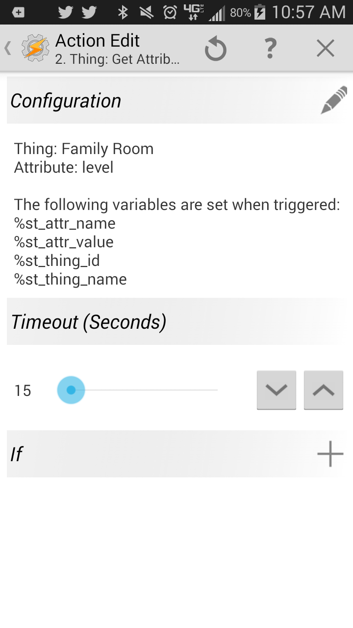

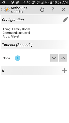

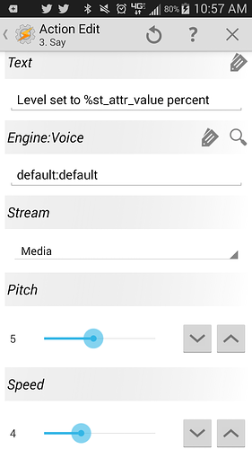

I forgot I also have it on my phone. This is an example for dimming a light. For Autovoice the Command Filter is ā€œset family room lights to (?.+)%ā€ I also checked the Use Regex box. Thats all I did in Autovoice. The tasks are:
I hope this helps.

The Command filter should have the word level in between greater than and less than signs between the ? and . For some reason the it was left out in the prior post even though I see it when editing it. Weird.
