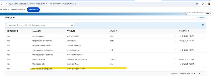

Hi @Mariano_Colmenarejo; Today I am testing danfoss Ally 014G2460 TRV with your driver in ST and when I go into the object screen always shows the message: “Este dispositivo aún no ha actualizado la informacion de su estado. Consulta de nuevo mas tarde”. Any idea? The device has been configured since this morning (about 10 hours ago)
Hi @Esmalaz, Mario
All the Danfoss TRVs that are in the stock and mine have the thermostatOperatingState capability in the profile and it is the one that is causing the error in your case, the state, Idle or Heat, has not been emitted.
If you first paired it with the stock driver and then changed it to my driver, then I recommend that you reinstall it directly with my driver so that the reports of all the attributes are configured. The stock driver does not configure the reports of that Thermostat.attributes.ThermostatRunningState, mine does configure it during the device installation.

Hi again Mariano,
I am watching that from ST web device:
Is normal an empty value in TermostatOperatingState ? Another thing I see is that the device status is undefined although I can manage it correctly. Any idea?
