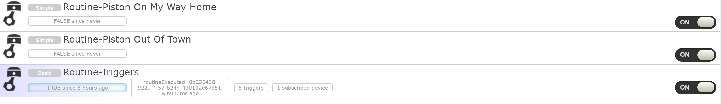

Here is some refinement:
So a single Piston to Bridge your ST Routines to your Routine-Pistons:
Then each set of actions you wish to execute are grouped into logical containers I call Routine-Pistons. I keep these separate from the triggers above, because I want to be able to execute or call these pistons from other pistons and I believe that having conditions on them prevents them from being called/executed unless those conditions happen to be true when you call them.
Ahhhhh… Rereading this… Yes I see what you’re doing and how that is definitely different from the way I’m doing it.
I agree that to call these actions from other pistons there can be no conditions included.
